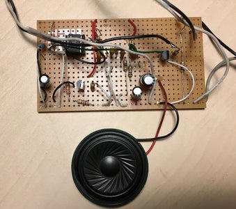

The circuit is assembled on a laminate board sized 90 x 50 mm. The power is supplied by 4 x 1.5 V batteries (6 V in total).

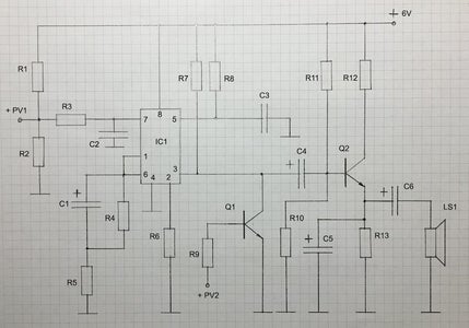

Step 1: Description of Circuit
The circuit is based on an IC LM331 that converts voltage into frequency; thus, if the voltage applied to pin 3 changes, the IC’s output frequency also changes. A solar cell battery PV1 produces this voltage; the performer covers or uncovers the battery with his/her hand thus changing the amount of light falling to the battery. Therefore, the battery’s voltage and, by consequence, the sound’s frequency changes.
Resistors R1 and R2 form a bias that doesn’t allow the frequency to decrease significantly when the battery is completely covered.
The signal from pin 7 enters a preamplifier built around Q2; a small loudspeaker LS1 is connected to the preamplifier’s output just to show the device’s work in the video. A power amplifier would be needed to get a louder sound.
The volume is controlled by changing the voltage produced by the solar cell battery PV2. This voltage is applied to the base of Q1 to open it progressively; the more Q1 opens, the more signal from pin 7 goes to the ground instead of entering the preamplifier; therefore, the sound’s volume decreases. The volume is maximum when the battery is completely covered with the performer’s hand.

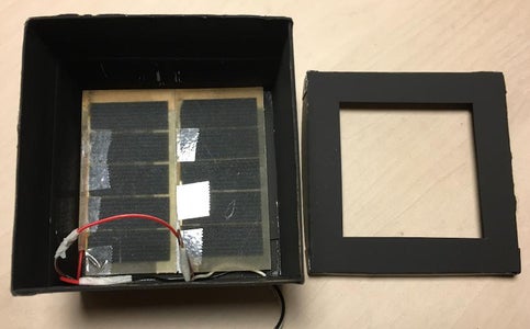

Step 2: Pitch Control Cell
Solar battery PV1 is a battery from an electromechanical toy, its voltage changes between 0 and 1.5V. The battery is placed into a cardboard box sized 70 x 70 x 70 mm; thus, the light can fall to the battery only from above; otherwise, the light reflected from the table’s surface would have influenced the battery’s output.
Step 3: Volume Control Cell
Solar battery is from a solar powered garden lantern, it develops voltage between 0 and 0.8 V. In fact, some elements of the battery were not functional, so I had to use only those that worked. The battery is placed into a box sized 85 x 85 x 70 mm; I also had to make a cover with a 60 x 60 mm opening to be able to completely cover the battery with my hand.
