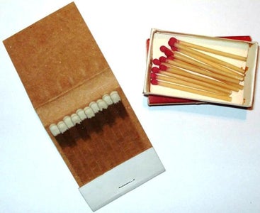

To build your little rocket you need:
  • 4 Matches (wax paper toothpick matches are better)
  • 1 little pice Tinfoil
  • Open space
Step 1: Step1 the Rocket Fuel
The first thing to do is select three matches that have approximately the same length and the same head size, it is not really bad that they are not identical, but it will greatly facilitate the construction work and the launch if they are similar.
With the three selected matches, place them together stacked one next to the other, so that the heads of the three matches are in contact.
