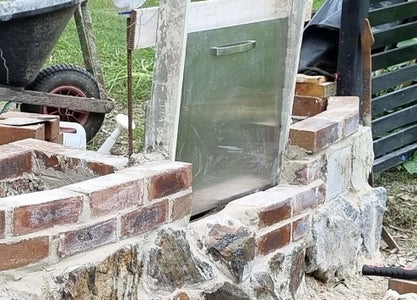

Step 6: Parcel Door
The Parcel door was the most confusing part that I wasn't sure how to do. I looked on the internet and most parcel boxes are a seesaw balancing act. They use a long panel to counterbalance the door closed and it acts like a slide for the parcel to go down. I didn't want to get to high above the ground, I wanted the parcels to go in at a lower height so they don't have to fall to far. This would also keep the mail box lower and not so much work.
My wife insisted that bigger is always better and wanted a big one for larger parcels.
I used a stainless steel under bench, fridge door from a restaurant. I used a 40 x 40 square gal length screwed into the bottom to act as a counter balance and door closer. I balanced the door on a 10mm threaded bar laying on the ground when I found the balancing point I marked it, then I moved another 20mm to make sure I was past the balance point.
I cut some more 40mm gal box steel to strengthen up to the balancing point and drilled it out to suit 10mm x 80mm stainless bolts.

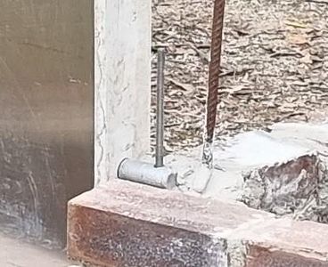

For the hinges I just used some old risers from my smelting leftovers they were about 30mm round, ( You can just buy some 30mm Alu round bar from a supplier). I drilled it out to suit a 10mm tap in the center and machined 20mm back from the end to tidy up. I also put in a 10mm vertical threaded hole for a bar to tie it into the concrete.
I used some wooden 100mm boards to help hold the door and hinges in place while I bricked up around the door. I bricked as close as possible then concreted up to the wood for a flat vertical surface.
I bent the stainless tie in rods back away from the wood. When I got above the hinges and as soon as I could fit a brick in I removed the timber and bricked the rest of the way up. Unless I point it out no one has noticed the missing bricks below the hinges.

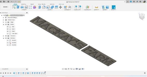

We are Mackay's descended from the Pict's so I thought here would be a good opportunity to expose some of our heritage. I looked through and found some generic pictures on line, of the tree of life. There's heaps of free files and downloads or you can pay and get a special one. ( After seeing all the history I got inspired to sit down and draw a new family crest. I'm Raphael and my son is Claymore and Manu Forti is the Family Motto. )
For the tree of life I used idea maker and printed off the jpeg that I had saved. I had a few goes in the end, I printed a 3mm thick base total height of 7mm a blending of 4.
I also used fusion 360 to make the name name plate. My ender 3 only has a 225mm build plate so I made rectangle boxes for the letters to fit inside. When printed overall letter thickness was 7mm. This worked out except for the tapering of the letters. In fusion it's hard to taper writing.
I sanded and painted the prints with 2 coats clear acrylic lacquer. This helped to smooth the surface for casting in sand.
I cut a piece of 12mm plywood to 900mm x 110mm to screw the letters to. I also cut a piece of 12mm x 30mm wood to attach to the mold for the angle part. I used a electric plane to taper it and 3 screws to fix it in place when making the mold.
