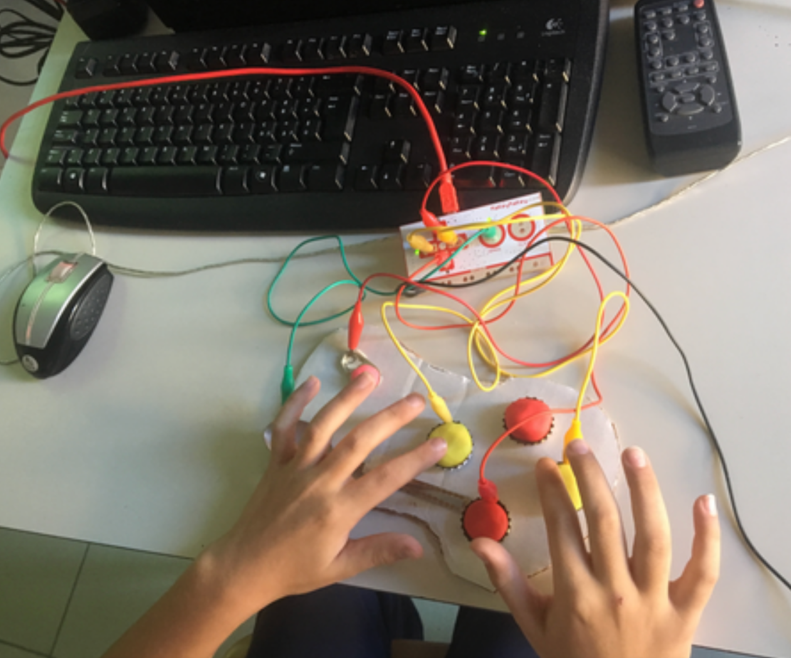

  1. Connect all the crocodile clips with the elements of the interactive panel making sure that the conductive paint is in direct contact with clips. (Picture 1)
  2. Connect the red USB cable to Makey Makey and to the computer. (Picture 2)
  3. With one hand touch the grounding cable and touch each element of the panel with one finger of the other hand and for each object you will hear the corresponding sound. Test! (Video)
