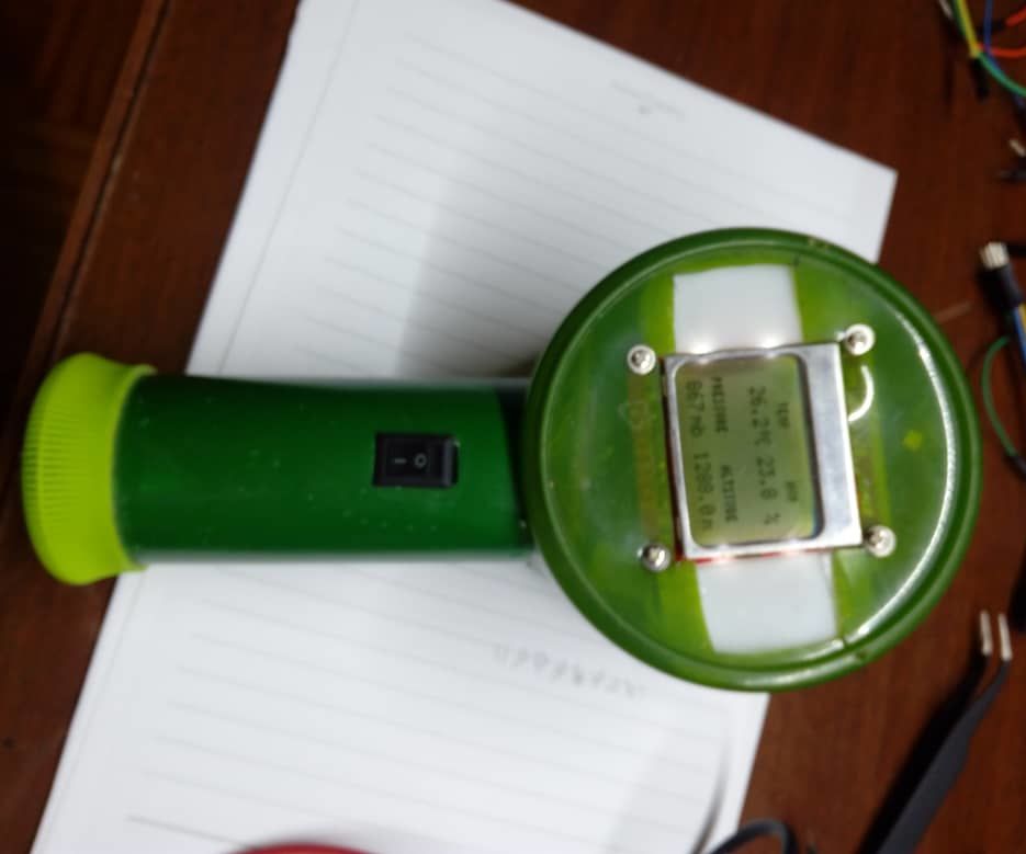

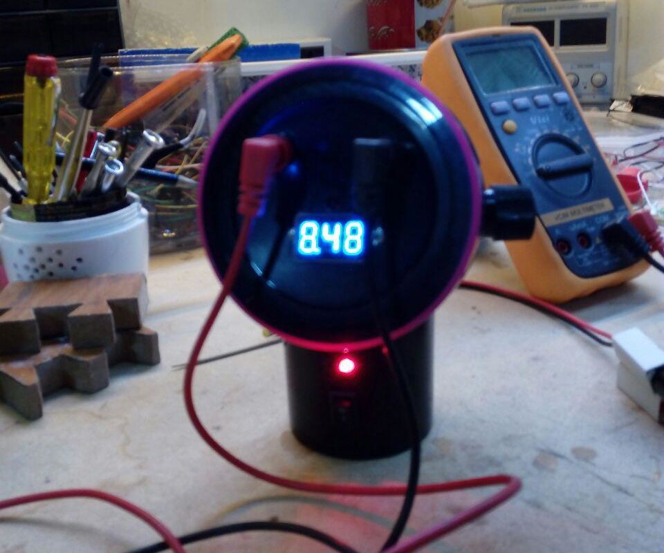

Sometime ago I made a power bank by inserting three 3.8 V laptop batteries in a 20 cm PVC pipe with diameter of 5 cm and putting a rocker switch to turn it on and off, for my projects, this power bank produced 11.9 V and was very suitable for my hobby electronics projects, recently I decided to use this power bank as flash light the reason is to see how can I merge three features, flashlight, Bluetooth speakers and charging cell phone all in one, so as you can see in the first photo this power pack could be seen, as you can see I have used two pieces of electrical duct to place the laptop batteries in it so that it gets fixed inside the PVC pipe and do not move and also for the ease of maintenance, you can slide the battery block out and troubleshoot it if it will be needed. So this part was already made by me nearly two or three months ago, the lower cap was just fitted for recharging these batteries and not for a USB female so I changed it to another cap which is orange color while the first one was a milk bottle door with green color. Therefore the materials and components are as follows:

Step 4: Comparing This Flash Light With My Previous Flash Light
You can see this one is much bigger (because of power bank) and the switches are put on the back of the flash light, because it is safer to switch the light on when the light is not toward your face( A design correction!)
