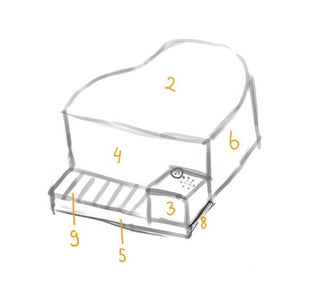

First you make a sketch for what you want your piano or instrument to look like, as you can see I had different ideas for it but ultimately decided on a classic piano shape. You sketch out the shape you want on a piece of paper and cut it out from cardboard. You do this twice and you'll have the bottom and topside of the piano. It helps to put your circuit assembly on the cardboard to see how much space you need.
After that you can cut out a long piece of cardboard, the length depending on your piano shape, and bend it to fit around the bottom and top side. Next, I made a panel to separate the wires from the buttons and hide the rest of the electronics behind it.
The piano keys are pretty easy to make (see fourth picture), you have to bend the end in a zigzag shape so that the key always bounces back up once you've pressed it. I made seven of these. For the eighth button I made a different design since I wanted this to be my button for playing melodies. I cut out a small round shape and a small thin strip that I bent into a zigzag shape. Glue them together and you have another button that bounces back!
Lastly I made a bunch of small boxes to hide the breadboard and any other Arduino components you weren't supposed to see.

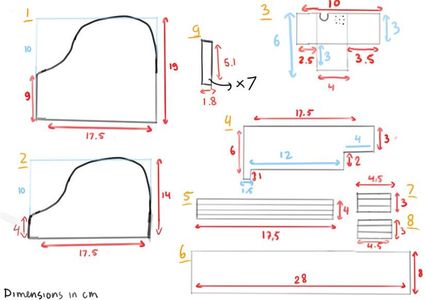

Detailed description (length, height, width):
The exterior consists of 9 main components. I made a sketch that includes all the dimensions of the parts and numbered them from 1 to 8 (see last picture):
- The base of the piano. The breadboard, battery holder, and Arduino Uno will be secured to this at a later point.
- The top of the piano.
- A box for the Piezo buzzer and song button.
- A panel that creates a barrier between the wires and the buttons.
- A box that hides the front of the breadboard.
- A long piece of cardboard that stretches alongside the sides and back of the piano.
- Boxes to hide the short sides of the breadboard.
- Piano keys
