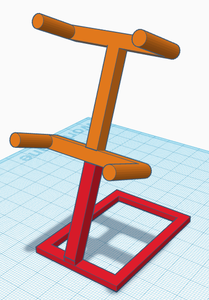

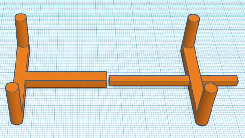

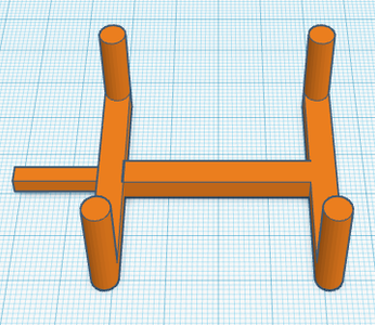

First, I designed an adjustable apparatus that can hold a yo-yo. I decided to design a sliding mechanism so that once the two pieces are slid together, they can be adjusted to the size of the yo-yo (see images 1 and 2). This sliding mechanism uses a prong that goes into a space that is slightly larger than the prong (around 0.4mm on each side).
The yo-yo is held by 4 circular prongs (see image 2), which can hold almost any shape of yo-yo, including the circle and the square yo-yo I designed. Each prong is around 40mm apart. I also designed it to be held together by a rubber band, as it would hold the yo-yo tight and the apparatus together.

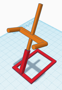

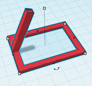

I also added a prong sticking out from one of the pieces so that it could be held by the base using the same mechanism to attach the two pieces that hold the yo-yo (see image 2). I then designed a base with a wide bottom (see image 3) to keep it balanced. Additionally, I added a place in which the piece with the prong could slide into (see image 4), holding both of the pieces that hold the yo-yo (see image 5). All these pieces were designed using Tinkercad.

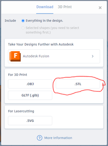

Then, I exported each file on Tinkercad by clicking export at the top left of the screen (see image 1). Then, I clicked STL under "For 3d Print" (see image 2).

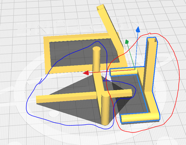

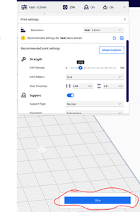

Next, I imported each file into a slicer (I used Ultimaker Cura) and I rotated each object to make most parts printable without supports (see the part circled in red in image 3).
Then, I sliced it at 20% infill with a 0.2mm layer height, a brim for bed adhesion, and supports on (see image 4) (this is used for the middle piece with the 2 prongs (circled in blue in image 3). Then, I clicked slice (see image 4). This results in a GCODE file that can be used on a 3d printer. Then, I clicked "Save To Disc", saving it to my computer (see image 5).
