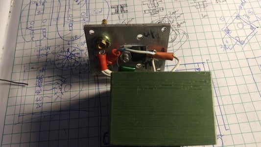

The wiring was simple, I used ring terminals in which I crimped and soldered the wires to connect to the banana male plugs and female sockets as shown. Rest of the connections were point to point.
Note: The center-to-center spacing of the plugs and sockets should be exactly 0.75 inches apart as that is the standard spacing on power supply sockets.

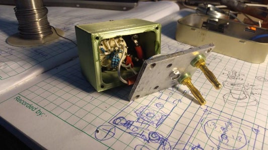

Step 2: Assembling the Little Unit
The resistors were soldered onto the switch, the LM317 was attached to a small aluminum plate that serves as a heat sink, the banana plugs and sockets were attached to the 3D printed box and the aluminum plate and wires were soldered to the different points. The aluminum plate was then attached with 4 screws to the little 3D printed box.

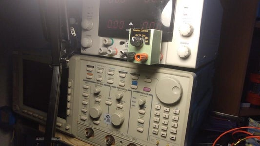

Step 4: Using the Constant Current Supply Module
The small module is plugged into an existing power supply's output sockets, the switch is set to the required maximum current and your device is then plugged into the constant current modules output socket.
