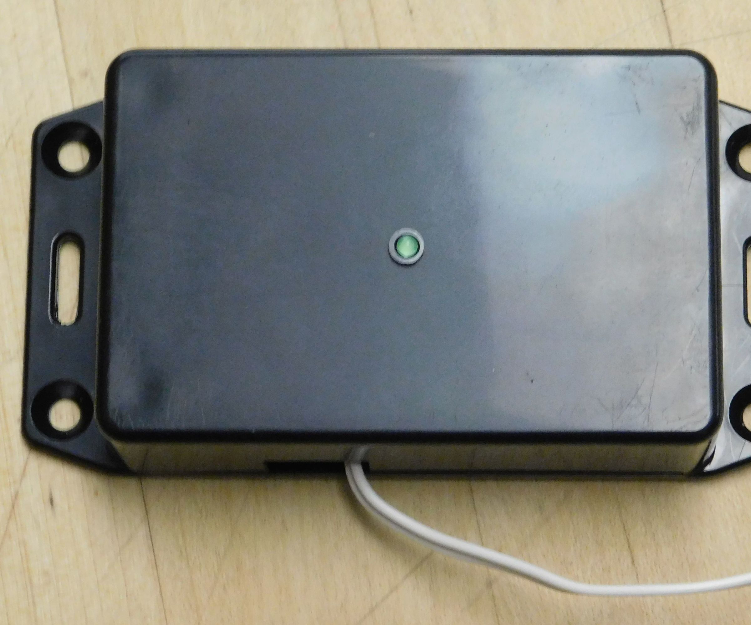

Because an RFID controller is usually used as a security device for a door in lieu of a key or combination or keypad, the controller is separated into 2 cases. One case containing the LED and the antenna is placed on the "outside" of the door while the the other case containing the actual components of the controller is placed on the "inside" of the door.
All of the components are mounted on the perf board as shown in the layout drawing. The photo of the finished controller photo and the layout drawing have some minor differences. The position of the LED resistors are shown in the layout drawing along the top edge of the layout. In the photo of the controller, the resistors are actually on the bottom of the perf board. Also, the jumper labelled J1 in the component picture has been moved in the layout drawing to the bottom to the left of the D1 diode.
Power is supplied to the controller by a standard USB micro connector on the left side of the NodeMCU board. The connector socket is on the bottom side of the board, primarily to reduce the height of the plug. Control lines for the RDM6300 antenna and the dual color LED pass through the bottom of the "inside" case. The line enter the "outside" case through the bottom also.

When a user places a key fob against the front of the "outside" case near the LED, the antenna excites the RFID chip in the key fob which causes it to send it's embedded code to the antenna which connects to the RDM6300 RFID controller in the "inside" case. The RDM6300 decodes the signal from the RFID chip and sends the decoded RFID code to the NodeMCU.
The message is 12 bytes long. The first 10 bytes are the 5 ASCII hexi-decimal characters of the RFID chip in the key fob followed by the 2 byte hexi-decimal checksum for the first 10 characters.
The message is sent from the Tx line on the RDM5300 to the cathode of diode D1. The combination of diode D1 and resistor R3 acts as a level shifter. This is necessary because the NodeMCU is expecting a 3.3vdc signal but the RDM6300 sends a 5vdc signal. The junction of the D1 and R3 is then connected to the Rx input of the NodeMCU.
The software running on the NodeMCU determines if the received RFID code is valid. If the code is valid, the NodeMCU raises the output of GPIO D7 which energizes the solid state relay Rly1 and closes the normally open contacts of Rly1. If the code is valid, the NodeMCU raises the output of GPIO D2 (the green LED). If the code is not valid, the NodeMCU raises the output of GPIO D1 (the red LED).
If 4 consecutive invalid RFID codes are received, the software raises the fires the output of GPIO D6 which connected to the Rst GPIO when the J1 jumper is in place. This causes the NodeMCU to do a hard reset and reload itself. This is done to solve some potential problems, the first being that the RFID code is valid but the code has not been loaded when the NodeMCU last booted. This could easily happen if the RFID code was added to the RFID database after the last NodeMCU boot. There is also the possibility of the Wifi link going down. There is also the possibility of the Wifi DHCP lease timing out if the software is setup for DHCP IP address assignment which is the default.
When an invalid RFID code swipe is followed by a valid RFID code swipe, the invalid code counter is reset to zero and the NodeMCU continues as though there had not been an ivalid code swipe.
A note about J1: normally, J1 has a jumper shorting the two connectors that connect GPIO D6 to GPIO Rst. This allows the software to reset the NodeMCU under certain conditions which I'll explain later. Be aware, though, that if J1 is shorted, the NoderMCU can not be reprogrammed. In order to program the NodeMCU, the shorting jumper on J1 must be removed so that the programmer can access the the bootloader on the NodeMCU. In other words, remove the jumper to program and install the jumper to allow the software to reset the NodeMCU. More info follows during the discussion of the operation of the NodeMCU software.

}The NodeMCU code starts with the necessary include files for the ESP8266 processor to communicate with the network. This is followed by a bunch of variable declarations that'll be used later in the program. You have to provide the correct SSID and password or key phrase for your network wifi access point. You also need to provide the correct web address in the get_host variable for the host for your web and database servers.
A bit farther down is another variable, securityKey, which is just a string of random characters. This variable is sent with every request to the web server and must match the value in the same variable in the PHP files that are used by the web server to access the database server. This is just a simple security feature that prevents unwanted visitors to the web server from accessing the database. If an unwanted request to the web server doesn't have a posted securityKey variable that matches the value in the PHP file, the request will be ignored. Every RFID controller that accesses this web server will have to use the same securityKey string value.
When we get to the setup routine, a number of things happen. First we store the time that the program started. This is simply the zero time of the NodeMCU's internal timer. Later in the loop routine, the program will check the time that has elapsed since the start of the program. If the eleapsed time exceeds 6 hours, the RFID Controller will automatically reset itself, reload the program and reconnect to the network. You can decide if your network is reliable enough to remove this function.
Next, the program tries to connect to the Wifi network. Assuming that the NodeMCU connects, the program starts a web client to communicate with the web server so that the program can get a list of valid RFID codes from the web server using the get_rfid_list function. Finally, the setup function signals that it is complete by flashing the red and green leds 5 times. Now that the setup function is complete, the program enters a continuously running loop function called (what else?) loop.
The loop function's task is to look for codes sent by the RDM6300 receiver and validate the codes. For every iteration through the loop, the program checks for a character from the RDM6300. When the loop has received 12 characters, the program will check to see if the code is valid. The first 10 characters of the 12 received characters are the actual RFID code. The remaining 2 characters are the the 2 checksum characters that the RDM6300 adds to the RFID code. The 12 character codes are stored in the database so if desired, the checksum of the 10 character received code can be calculated using the getCkSum function. In this program listing the getCkSum is disabled because I have never had a bad RFID code transmitted where the calculated checksum is different to the transmitted checksum. I guess in a noisy RF environment a corrupted message could be transmitted by the RDM6300 but I haven't experienced one. Your mileage may vary. If you need it, uncomment the 4 lines to enable the getCkSum function.
The program next sends a request to the web server to validate the received RFID code using the get_device_status routine. This routine first checks an array of valid RFID codes that were loaded by the setup function when the program first loaded. If the RFID code is not found in the array, the program composes a database request and requests the web server to run get_rfid.php using the received RFID code as a search value. If the web server finds the RFID code in the database, it returns a "Y" to the NodeMCU program. If not, it returns a "N" to the NodeMCU program. The PHP programs on the web server do a couple of other things which we will get to when we discuss the operation of the web server programs.
If the web server returns a "Y", the program fires the green led and resets the resetCnt variable to zero and sends another request to the webserver requesting the web If the web server returns a "N", the program fires the red led and increments the resetCnt variable by one. If the resetCnt variable adds to 4, the program executes the resetFunc routine.
