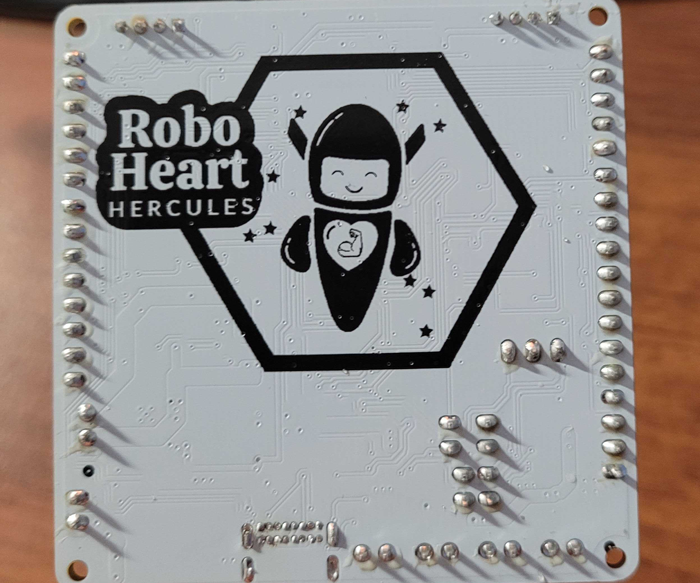

Step 1: Fasten Your RoboHeart Circuit Board
  • Attach the spacers to the four corners of the Roboheart.
  • Break the pin headers into 4 pieces with each piece containing 5 pins to make a "connecting base" between the RoboHeart and the Bread board.
  • In each of these "connecting bases" remove the metal on the center pin which makes it easier to insert in the bread board.
  • Insert the "connecting bases" on the bread board and fix the Roboheart on top of it and glue it in to secure the board.
Step 2: Check! Does It Fit?
You should be able to insert and take out the RoboHeart easily from the Breadboard after Step 1.
Just like in the video :)
