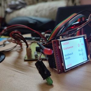

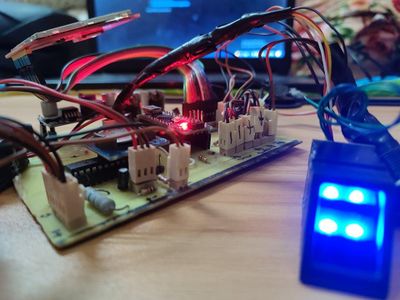

It has very simple working principle . When the new passenger enters the public vehicle , He/she should place their thumb finger in the fingerprint sensor. After they place the finger , the device make new registration and provide unique id to that person . At the time of the registration the device also record the pulse generated from hall effect sensor as a initial value. Now when the same person reaches the destination , He/she must place the same finger in the device . when the fingerprint sensor finds the registered finger it understands that person has reached the destination . At this time the device set the final pulse and calculate the distance traveled by passenger by generating the difference between the final pulse and the initial pulse . We can easily multiply the distance with any constant value to generate the fair as rules and regulation . If you have any discount card like(student card , old aged card ) , you can press the discount button available in the device to achieve the available discount . The owner of the bus can also calculate the total passenger and total amount of money collected at the end of the day or at the end of each tip by pressing the reset button . After pressing the reset button all the data will be erased from the device and will be saved in sd card for further data analysis . This device helps the owner of the bus to know the exact idea about the total money collected from the bus.

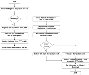

Flowchart
The flowchart of the project flows in following sequence

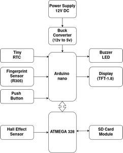

Step 1: Block Diagram
The Block Diagram of the project is explained in following blocks
Working Principle

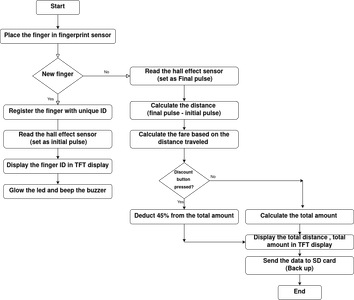

Step 2: Flow Chart
