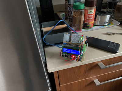

This is a device to count how many snacks I have taken from the fridge in out kitchen. There is a story behind this. During the pandemic I was in home office like the rest of us. For me this started in March 2020. I had been in Italy before and was likely infected so I stayed at home as soon as I was back from the trip. Over the first 3 months I gained 5 kg of weight. When I complained about that to my wife she simply asked me if I had counted how often I went to the fridge for a snack during a typical workday. I answered, I would estimate 4 to 5 times. She just shook her head.
So I build this device to count it reliably and found that it was 20 times in a typical workday.
This is a silly solution because I just could have counted on a list. But I was bored and wanted to build something. After all, there was not much more to do during the time. It is also silly because I used BASIC as a programming language on my Arduino UNO. To sum it up, a useless device programmed in an obsolete language. But it was fun nevertheless.

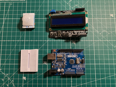

I will used and Arduino UNO and a standard LCD 16x2 display shield with buttons to build the solutions. There are other options which I will mention further down in the text.

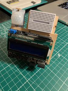

The key component is a standard PIR sensor, which you can see in the picture on the upper left side. These sensors get active if something comes near them.
Mount the Arduino, a few plywood pieces can be used. Essentially we need to build a little stand so that the Arduino and the sensor can be mounted on it. A small breadboard is helpful for extension of the device. Maybe you want to add a traffic light and use a few LEDs with the right resistors for it.

Step 1: Prepare the Components

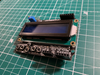

Display shield usually come without connector sockets in the front. They can be plugged on the UNO and then cover all the pins. I usually solder connectors on the shield right away. You can see this in the first picture. If you cannot do this then you can also squeeze cables into the sockets of the Arduino before you put the shield on it.
For this device I made a little stand from spare plywood pieces, screwed the Arduino of it. On the upper side of the stand I mounted a small breadboard and the PIR sensor itself. They usually come with screw holes. I used a small piece of wood to mount it, antenna style on top.
This is all the hardware work needed for now.

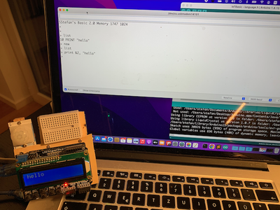

Opening the serial monitor with 9600 baud and NEWLINE as serial settings you will see the BASIC command prompt
Stefan's Basic 2.0 Memory 1747 1024
On this prompt > you can type in commands interactively and control many features of the Arduino.
A full tutorial and manual can be found here: https://github.com/slviajero/tinybasic/blob/main/MANUAL.md
For now, type in
PRINT &2, "Hello"
on the command line. The text Hello should appear on the display as shown in the photo.
BASIC is an interpreter language and all commands can be entered at the command line. They are executed immediately. If you start a command with a line number, it is stored. The NEW command deletes and existing program and the LIST command shows the program. If you are unfamiliar with BASIC,
NEW
10 PRINT "Hello World"
20 PRINT &2, "Hello Display"
LIST
RUN
Hello World
The display should show "Hello Display"

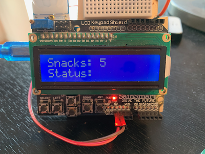

Now we can add the display code. For this add the following lines:
20 CLS: PRINT &2,"Snacks: ": PRINT &2,"Status: ";
110 @X=8: @Y=0: PRINT &2,C;
Now the display shows the number of times the sensor was approached. @X and @Y are special variables in this BASIC. Setting them positions the cursor on the display. They can also be read.

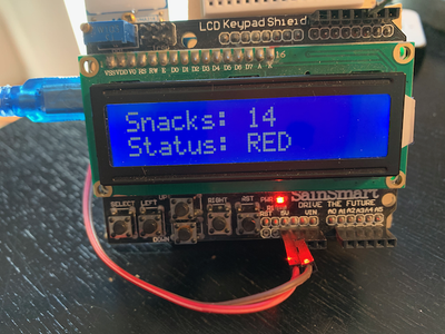

The last improvement would be to add some thresholds and a status message. Add the following lines for this:
40 RE=8: YE=4
130 ST$="GREEN"
140 IF C>RE THEN ST$="RED" ELSE IF C>YE THEN ST$="YELLOW"
150 @Y=1: @X=8: PRINT &2," ";: @X=8: PRINT &2,ST$;
Now the display also shows the snack status.The snack status is stored in the string variable ST$. Strings by default are 32 characters. They can be dimensioned to any arbitrary length. Everything up to 4 snacks is GREEN, from 4 to 8 we are at status YELLOW and above 8 the status is RED.
No more snacks allowed!

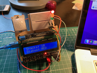

I tracked my eating behaviour with this device over a certain period of time. It was shocking. One day I had made 20 trips to the fridge for a little snack. No wonder I became fat quite fast during the pandemic.
One things is still missing. The device should start the program without typing in RUN from the command line once it is connected to power.
This is done by entering
SET 1,1
on the command line. With this setting the system is in autorun mode. The program in the EEPROM will start automatically. The setting is permanent. It can be changed back on the command line by interrupting the program with # and entering
SET 1,0
Congratulations! You build the first working snack counter.

Step 4: Show the Traffic Light
As we are already using traffic light colours to indicate the snack status, why not add a traffic lights with LEDs to it.

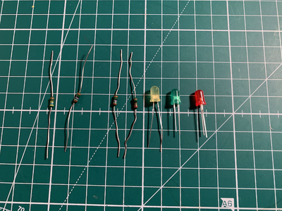

For this I added three LEDs in red, yellow and green. They are connected to pins A1 to A3 which translates to digital pins 15, 16, and 17 with 300 Ohm resistors.
The following lines would be needed in the program
50 PINM 15,1: PINM 16,1: PINM 17,1
300 DWRITE 15,0: DWRITE 16,0: DWRITE 17,0
310 IF ST$="RED" THEN DWRITE 17,1
320 IF ST$="YELLOW" THEN DWRITE 16,1
330 IF ST$="GREEN" THEN DWRITE 15,1
Line 50 sets the pins to OUTPUT and lines 300 to 330 switch on the appropriate LED.
This way you see if you still are allowed to open the fridge or if you are already past the maximum allowed number of snacks.

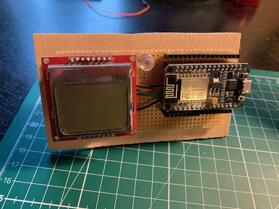

All this is written for an UNO and the standard 16x2 display shield. These are low cost parts which every Arduino enthusiasts has. My original build was with an ESP8266 and a Nokia display.
The BASIC interpreter supports several display and most MCU platforms. Please read my Wiki and the hardware manual if you plan another device.
https://github.com/slviajero/tinybasic/wiki/Hardware-Platforms
https://github.com/slviajero/tinybasic/wiki/Peripherals:-Display-LCDs,-TFTs,-and-VGA
You will need different settings in hardware.h depending on the display and the storage you use. ESP systems have a in flash disk that can store larger programs.
