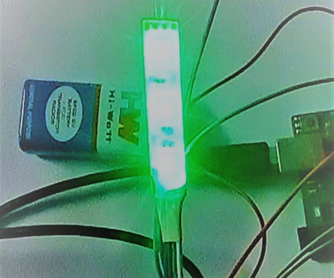

Step 3: Making
You will need a solder to complete the circuit in the PCB.
Before soldering in the PCB, try to create a prototype in a bread board and check the outputs of the MosFET and Transformer using Multimeter.
Based on the voltage and amp hours of the battery used as the input to the oscillator, the output timing will alter. But remember the more the voltage and amp hours the MosFET gets super hot so plan a correct radiator for it...
