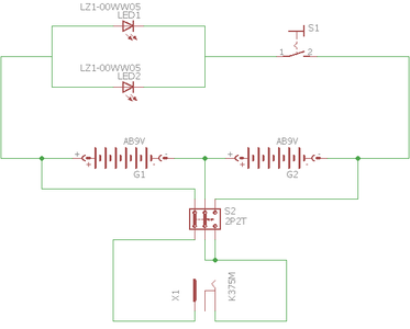

5 - Because the COB 5 W LEDs should work with 18 V potential difference so two rechargeable 9V batteries should be connected in series.
6 - Then, first mark the small holes for wires and screws of COB 5 W LEDs on the aluminum circular plate and then make suitable holes on it and attach to this plate and make wire connection to these two LEDs, they should be connected parallel to receive 18 V each.
7 - In this stage you should connect all components as shown in the circuit diagram and insert switches in to their relevant openings on the pipe.
