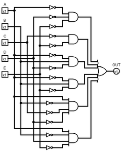

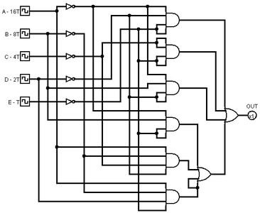

I'm using software called Logisim to generate circuits. It can take a truth table as input. You can also import provided circuit XML files into Logisim. The generated circuit is not perfect and can be improved manually by removing duplicate components and adjusting the number of inputs for logic gates. This process results in a simplified circuit. Additionally, I have added input signals for circuit simulation.
For creating new circuit follow these steps:
  1. File > New.
  2. Project > Add Circuit (or you can use main circuit, which is created by default).
  3. Window > Combinational Analysis.
  4. Write input names in second box and add them one by one.
  5. Select Outputs tab and add one (or more) output.
  6. Select Table tab and by clicking on each output, you can change its state.
  7. Click Build Circuit. If circuit diagram doesn't appear, there might be some issues in the table.

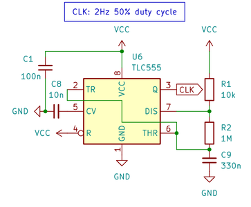

Probably one of the most well known IC is 555 timer. It can accomplish many different things, one of them is generating square wave. We can utilize it for our SOS circuit. I used 555 Astable Circuit Calculator for choosing circuit component values.
General rules are:
  • Choose R2 value much higher than R1 for 50% duty cycle.
  • C9 sets clock frequency. 330nF capacitor will generate 2Hz signal.
  • To increase frequency, decrease C9 value.

For generating our 5-bit input signal we'll need binary counter. A binary counter works by sequentially counting in binary, incrementing its value by one with each clock pulse.
Full circuit simulation with 555 clock generator, binary counter and logical circuit was done using Falstad. If link doesn't work, you can import attached file.
