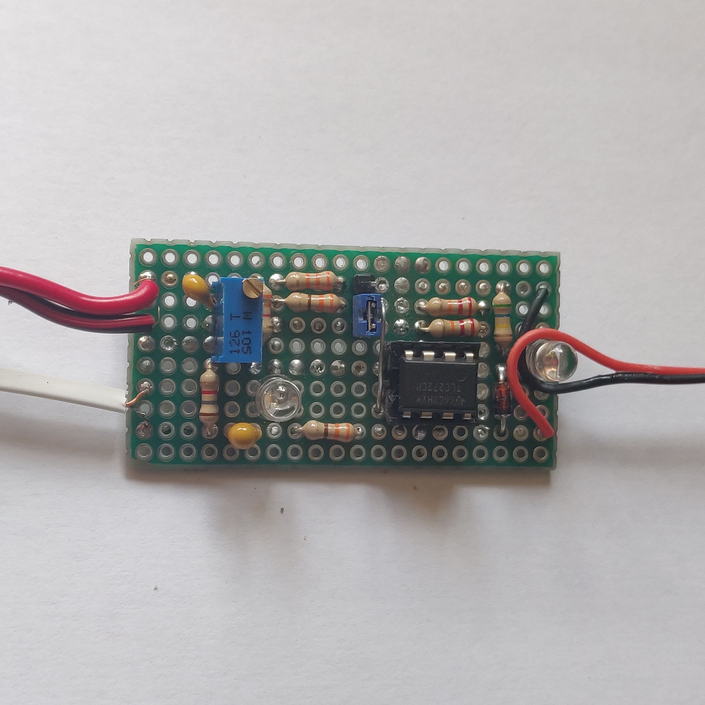

ADDENDUM: If you haven't ever used a breadboard, the new photo may be more helpful, with the purple blobs added to show which holes the wires plug into. Round blobs indicate where the visible wires go. Square holes show where the leads go that are covered by components, i.e., the input capacitor and the potentiometer. In each vertical column of 5, the holes are already connected internally. So are the rows of ten at the top and bottom, which connect to the + and - battery leads. The holes are not connected across the middle gap where the op amp and LEDs are plugged in.

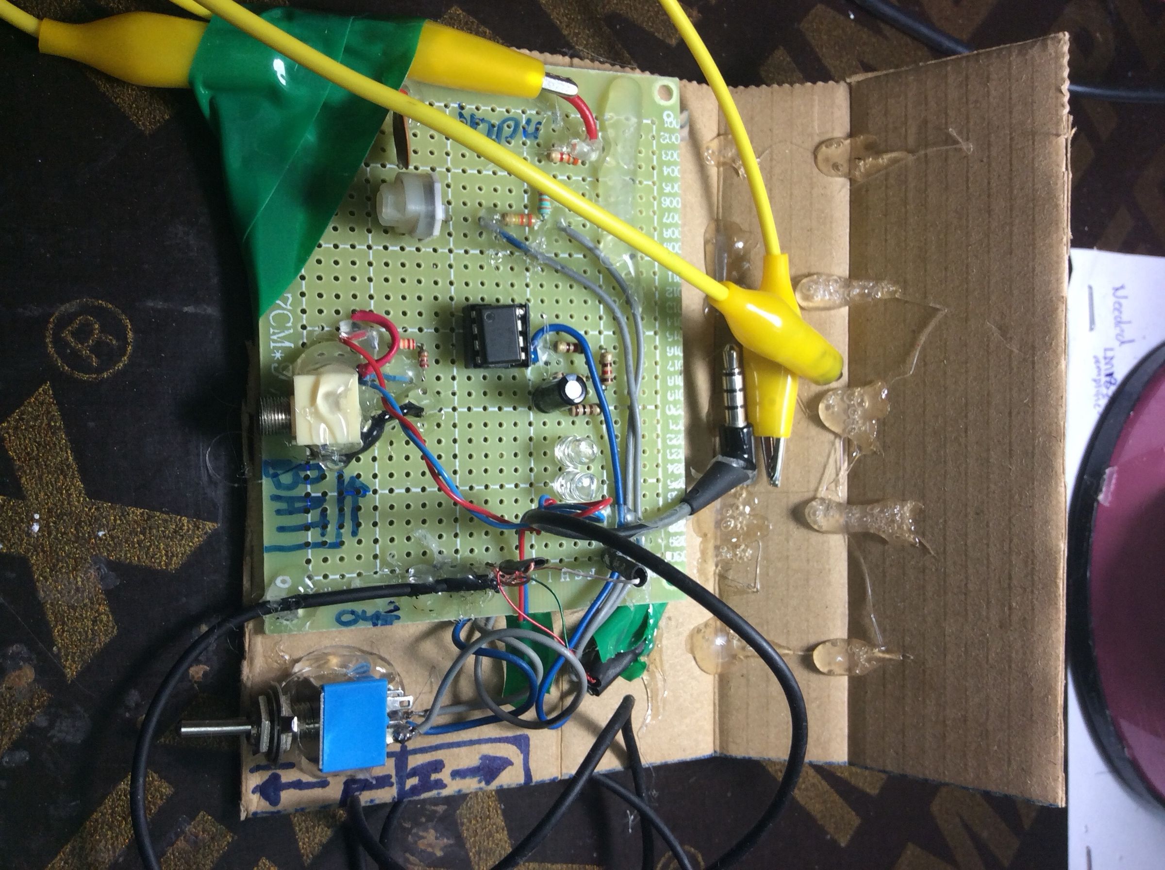

7 years ago
what other component can I used in replace with op amp tlc 272? thank you
Reply 4 years ago
Lm385, TL 072,TL 082
Reply 7 years ago
Rather than me trying to guess what your problem might be with the TLC 272, and then generating a list of possible alternatives, it might be more efficient for you to explain why that chip won't work and list what alternatives are available to you.
Reply 7 years ago

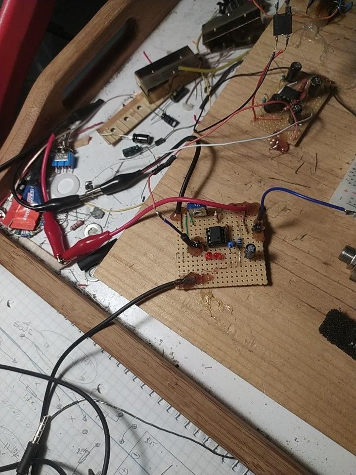

so I built the minimal circuit using the 4558d and i used a 9v battery with the same schematics but the problem is that the chip gets hot and i dont know if thats normal or not, also i replaced the 9v battery with an 11v from an adjustable ATX power source which made the chip very very hot!!
Whats going on??
Also, I noticed that the battery gives more cleaner signal than the atx ( connected to mains)
Reply 6 years ago
The chip should not get hot. Something is very wrong with your circuit.
