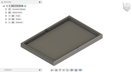

Step 2: Design With Fusion 360
After designing our project on paper we started creating it with Fusion 360. We designed the base with dimensions 16x11x1.5 inches. Then shelled it to.5 inches. Next, we created a slot on both sides that was a half-inch wide and a fourth inch from the outside as shown in the first photo. We then created the divider with the goal in the middle to fit perfectly with the board. Based on our dimensions we created a puck to go through our goal in the middle.

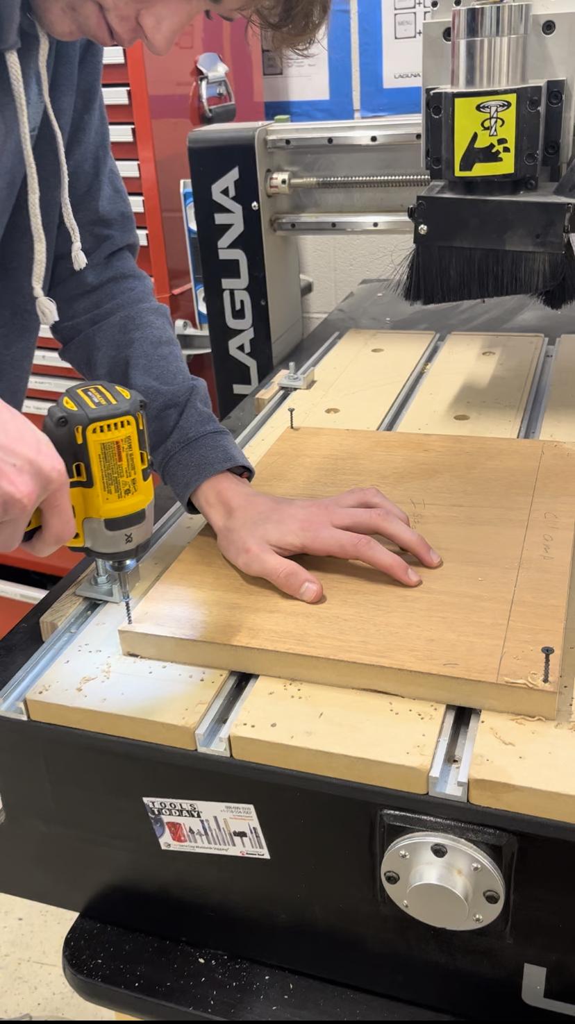

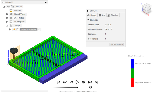

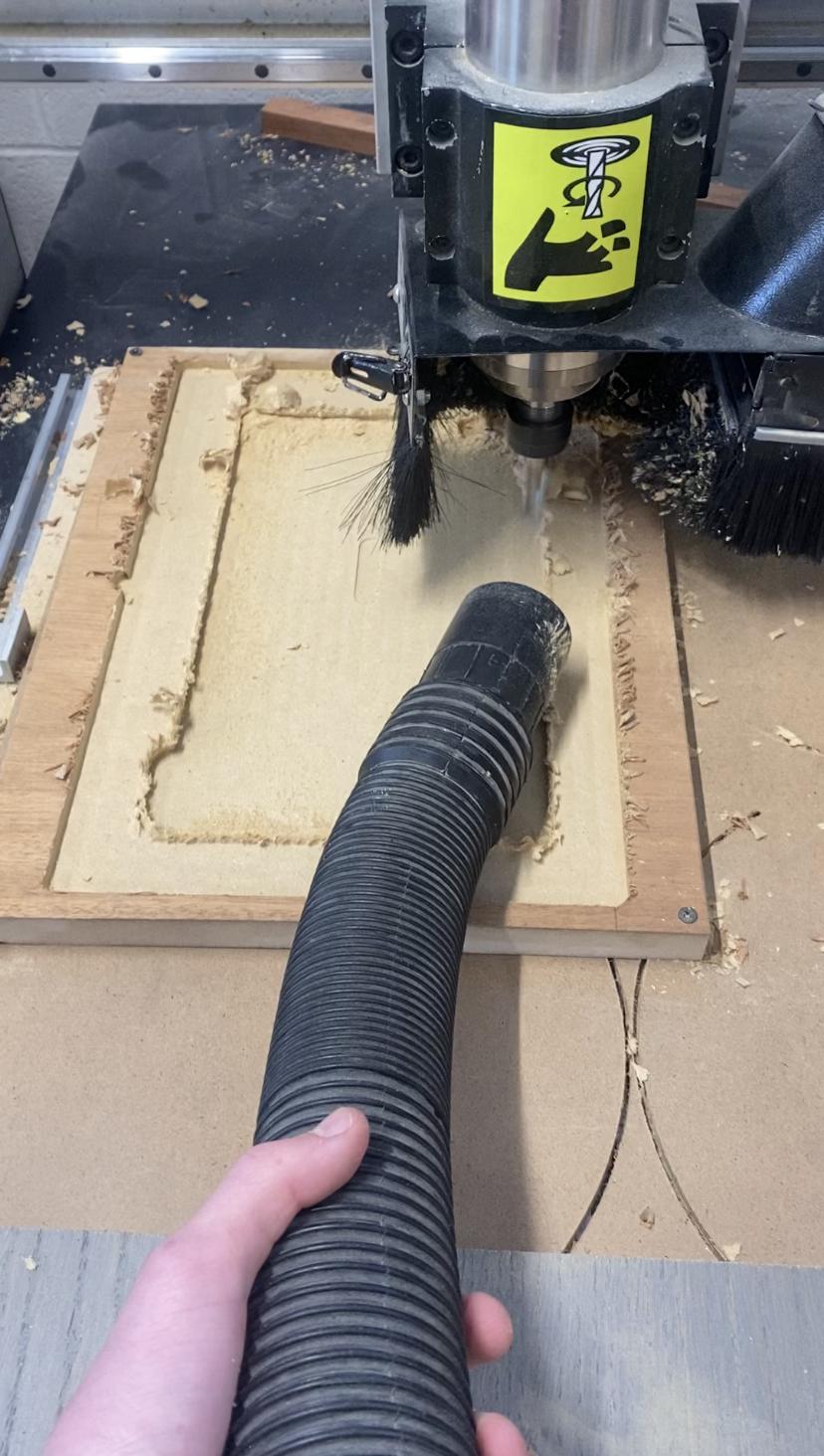

Step 4: CNC Machining
We screwed down the board game to the CNC machine so it wouldn't move. Then we used our program from Fusion 360 to cut it out. We had to send the CNC code to the machine through a flash drive. We then set the origin and let the CNC machine do the rest. We used a vacuum to collect extra sawdust that was being shaved out.

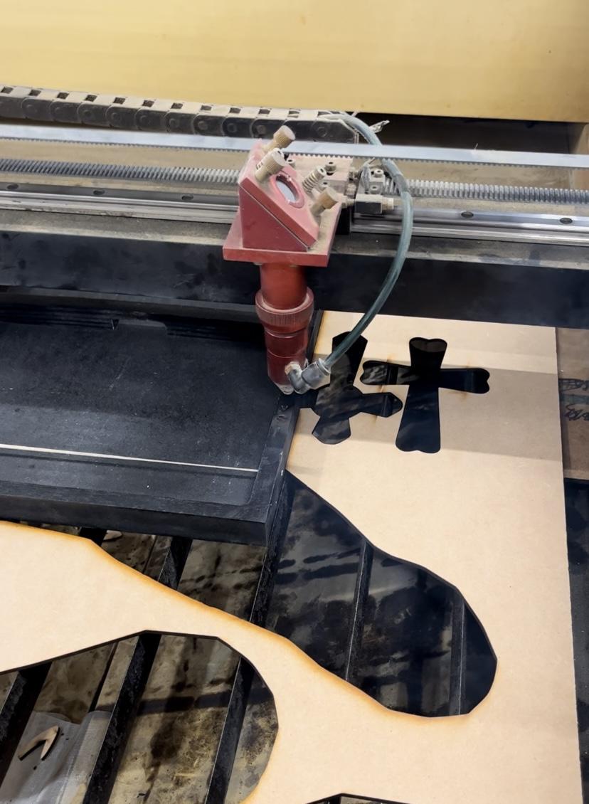

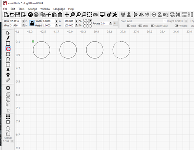

Step 6: Creating the Pucks
To create the pucks we used Lightburn and a laser cutter. We measured the dimensions according to the goal in order for it to fit perfectly but not too easily. Then we created the circles in Lightburn. To cut out the pucks we found wood with the right height and applied 100% power to cut through the wood. After they were cut out we spray-painted them white.
