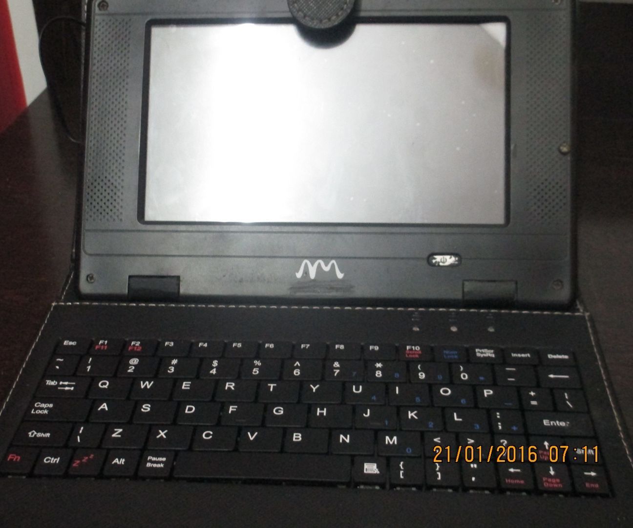

Step 5: Mount the Pi
Mount the Pi into the keyboard box using the 2.5mm screws.
Step 6: Monitor Power...
Add the boost converter to the mix. Connect a 5v source to input, and a multi meter to the out. Adjust the screw near the blue component till you reach 12v at atleast 300-400milli amps.
Now, add a 2.1mm barrel connection (male) to the output. The jack is a included component with the monitor. Connect the inputs to the pin no. 4 and 6. Take care. I'm not mentioning gpio no. One wrong connected wire will fry both the display and the Pi.
Step 7: Video Source..
If you're using NOOBS, some extra work. For imagers, pretty fast. Connect the 3.5mm to 3 RCA jack to the TRRS port on the Pi. Now depending on your cable, you might have to reverse the video and right audio cable. Or worse, you might have ground and video out reversed on the cable. If the latter is the case, cut open the cable and using a multi meter, check the pin out of the 3.5mm jack.
Step 8: Audio..
For audio. Just use a 2 RCa to 3.5mm female port. I prefer to go diy.
Step 9: Connect the Keyboard, Mount the Display, and You're Good to Go!
As above, never try to reverse ground and power.
Step 10: Choose to Cool the Pi With a Cooler Fan.
Cooling forcedly is better....... connect power to the output of boost converter..
Step 11: More 'you'ness?
For a unique touch, dremel and file down your own logo. I was using the Pi for a PC before this 'ible, so all desktop lovers, a cool custom monitor cable case..
Step 12: Finished!!!
WAY TO GO!
