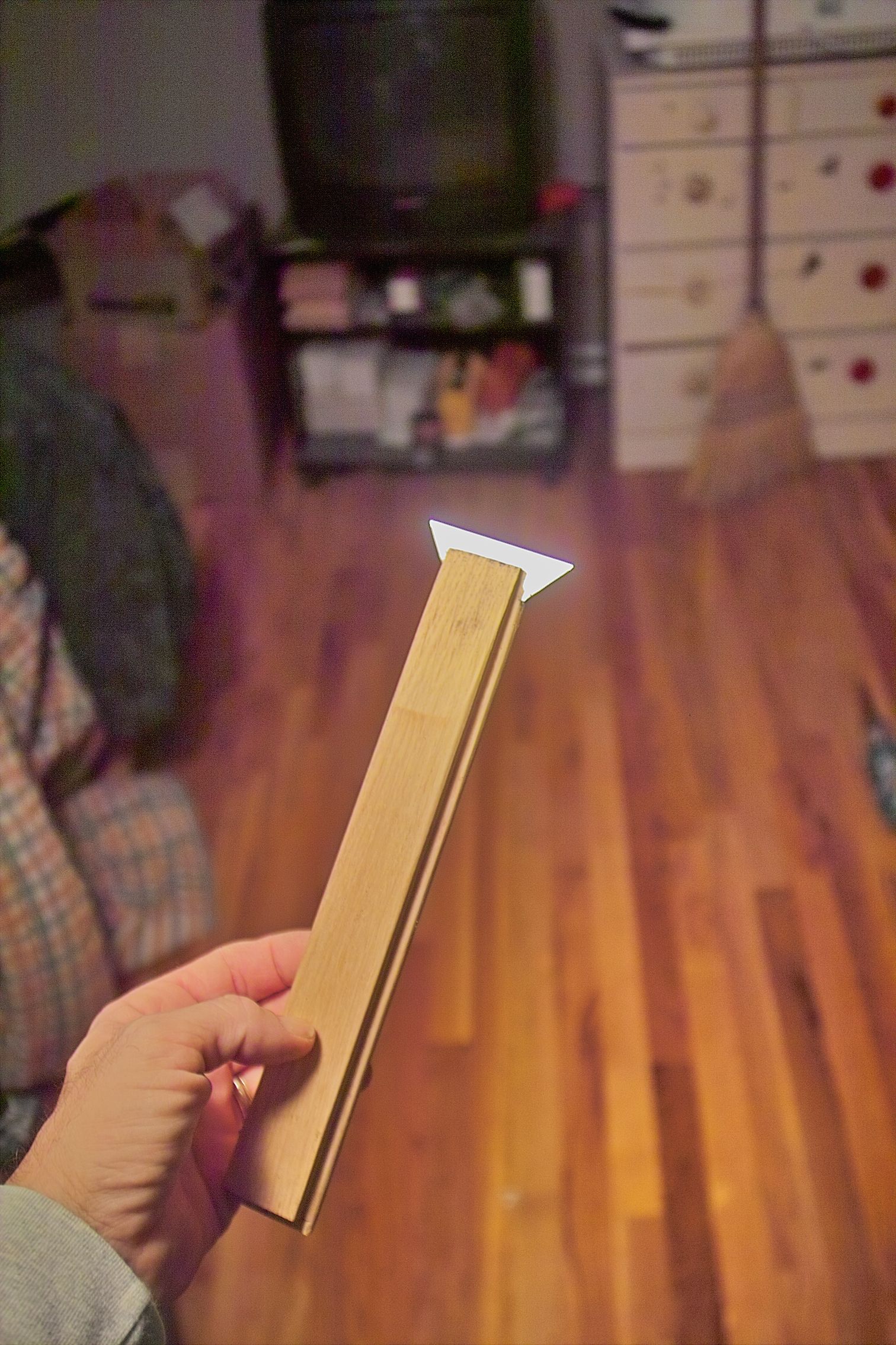

Step 2: Sorry to Throw a Curve.
Anyways, yes curves I had thought the slide needed to be a curve and with one pivot point yes that would have worked but since two are better than one I had to.
I basically made a channel for the 1/2 wide strip to slide in and out of using the 3/16th inch stock as side of a rectangular tube with the 7/8 inch strip being the top and bottom. This left a loose fit over about 2 inches of travel and was surprisingly smooth for a rush job when moved in an arc but since force really tends to go in straight lines, grabbing the two pivot points and attempting to pull them apart caused the arc to bind and log like a Chinese finger puzzle.
This might be handy to remember for something but benefit from my perfect hindsight make it straight to start with.
I turned it red with fire and hammered it flat real quick.
