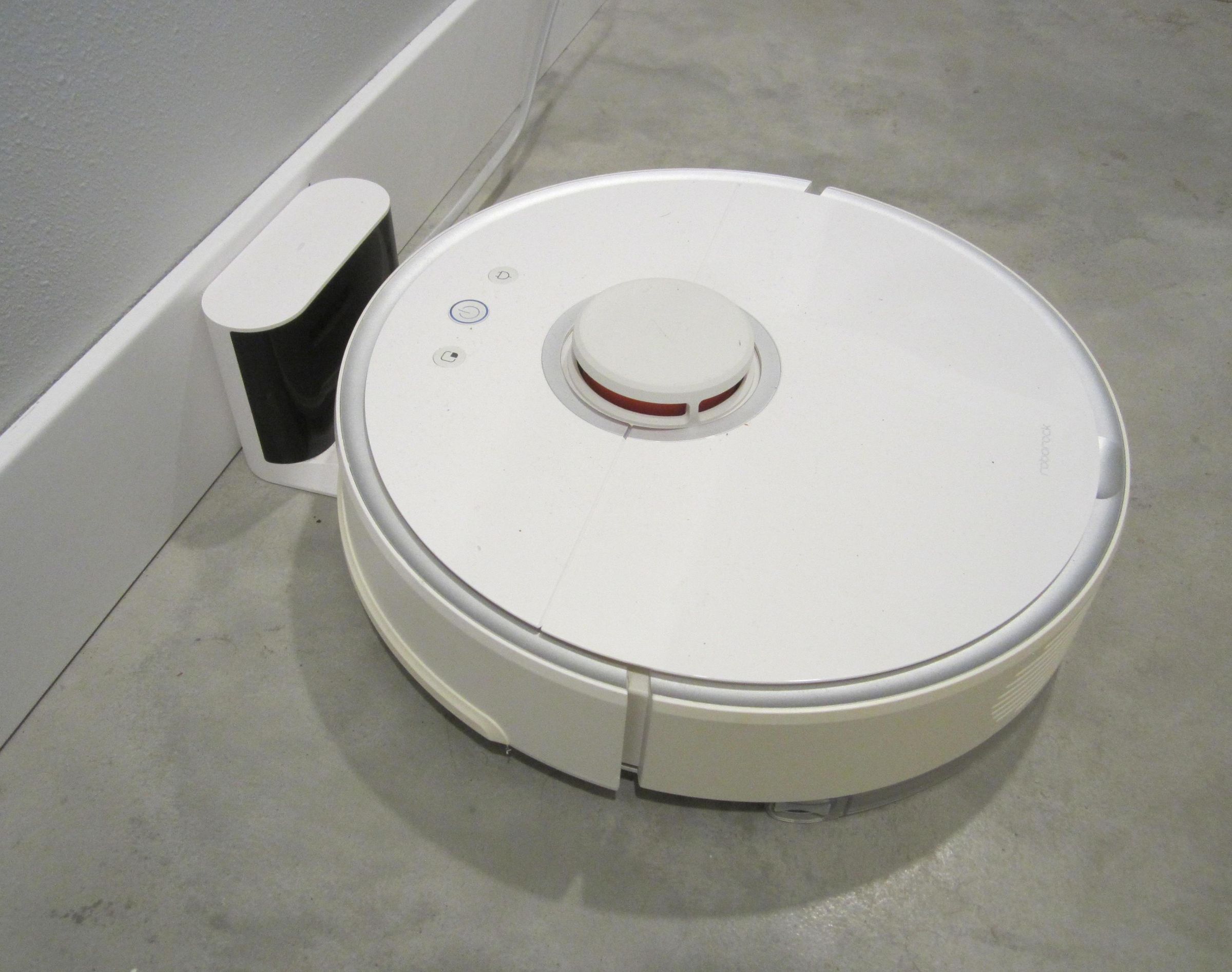

Introduction: A Roborock S5Max Rescue
About: Enjoy taking things apart to see how they work and seeing if I can put them back together again.
OK, So Now what?
I wrote an Instructable for disassembling the Roborock S5 and I said I intended to do the S5Max next. Recently, there was a discussion on Reddit where the consensus was to throw the 'bot out and buy a new one. I contacted the Original Poster and offered to pay shipping and handling to get it sent my way. He was happy to oblige me. Not only are we going to tear down an S5Max, but we will also explore what you will run into when trying to clean up an accident like this. Here we go!
You're going to need Phillips screwdrivers a #1 and #2 (preferably magnetic) and a pointy pick with a 90 degree bend. An Awl or a tiny flat bladed screwdriver will work along with a small Allen Wrench. The latter tools are to peel off the rubber covers for two LiDAR screws and the Allen wrench for tamping wires into wire ways. A camera, notepad and pencils for collecting your thoughts and a tray with 24 compartments numbered from 1 to 24. Given the nature of this project, latex or rubber gloves if you are squeamish, paper towels, and a large pan filled with water to wash plastic parts in. I was doing this outside under a covered porch and it was windy that day so my screw tray is in the white dishpan and you will see it clamped to the wash basin shortly. You may see some paperweights as well.
