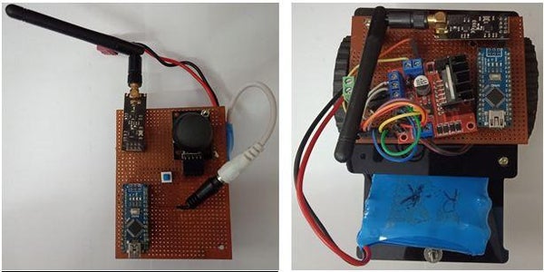

Development of Remote controller as a transmitter
Connection diagram of remote controller as a transmitter is shown in the Fig 2. It is consist of NRF24L01 transceiver module, Arduino Nano board, Joystick, DPDT switch and Battery.
Connection of developed remote controller as a transmitter is also given in the table 2. Connections points 1 of NRF24L01, Joystick and Battery with connection points 2 of Arduino Nano are also given the table 2.

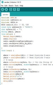

Step 5: Programming Code for Remote Controller As a Transmitter
Programming has been written in the Arduino IDE compiler and it is uploaded on remote controller Arduino Nano microcontroller board. Screen shot is shown in this step. Programming file can be downloaded and it can be used directly for operating the DC motor, Programming code is self explanatory in the programming code file.

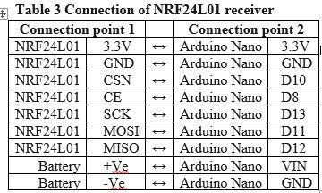

Connection diagram of receiver only is shown in the Fig 3. It is consist of NRF24L01 transceiver module, Arduino Nano board and Battery.
Connection of NRF24L01 receiver is also given in the table 3. Connections points 1 of NRF24L01 and Battery with connection point 2 of Arduino Nano are given the table 3.

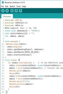

Step 7: Programing Code for Receiver
Programming code has been written in the Arduino IDE compiler and it is uploaded on receiver Arduino Nano microcontroller board. Screen shot is shown in this step. Programming file can be downloaded and it can be used directly by uploading in the board. Programming code is self explanatory in the programming code file. During the development of this project, all should check the transmitted data and received data for further step. in my case almost same data is received as transmitted by the transmitter during the development of project. Data received by the receiver is used for conditional code (if and else if case) for operating the motor in the final code. all should write down the received data in different operating condition such as Neutral, forward, backward, left turn and right turn. This data is used for final operating the DC motor program section.

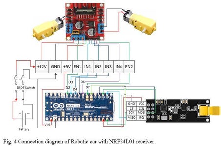

Step 8: Third Step As a Development of Small Robotic Car
Connection diagram of developed small robotic car as a receiver is shown in the Fig 4. Electronics parts consist of two DC Motors, Motor driver, Arduino Nano board, NRF24L01 transceiver and Battery.
Connection of developed small robotic car with NRF24L01 receiver is also given in the table 4. Connections points 1 of motor driver, NRF24L01 module with connection point 2 of Arduino Neno, Battery, and motors are given the table 4.
Previous motor and receiver programming has been combined and it is uploaded on receiver Arduino Nano microcontroller board. Programming file can be downloaded and it can be used directly in your project. Developed remote controller in the previous step has also been used for final project.
