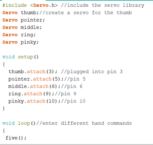

All servo motors VCC and GND connect to the motor shield VCC / GND inputs.
The signal inputs of all servo motors are connect to the motor shield ~PWM 3-5-6-9-10 respectively.

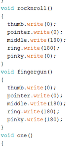

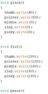

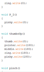

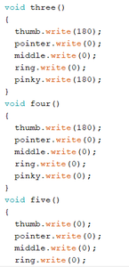

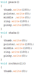

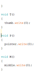

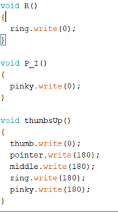

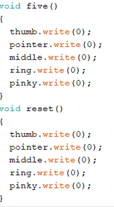

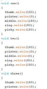

Step 4: Coding
To start coding the servos:
  • start off by adding the servo library into your code
  • name each servo as which finger they will be controlling
  • add the newly named servos into your code and choose which pin they will be connected too
  • make commands using each servo and changing the value between 0-180 degrees, 0 is when the finger will be fully closed and 180 is when the finger being full open
  • get your commands finished and add then into your loop so they will now control your fingers
  • now you can run your code while it is connected to and Arduino and your fingers should now work properly if steps are followed properly
