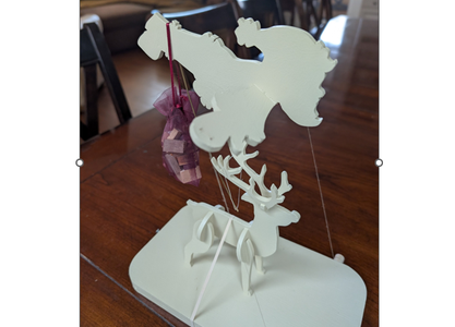

Next you assemble the deer and Santa to create the 3D components and paint. If you did the scroll saw well, the parts connect together without needing glue.
Step 4: Assemble System
Ok this step took a few experimental tries. Originally, I was going to use those stirring sticks you get at Starbucks for the level element but I was making something else using metal rods so I thought that might work better. I hammered one end flat and then drilled a hole to hold a loop of fishing line. Then I drilled a hole in Santa's shin (sorry Santa) and some holes in his mittens to accept thread. Finally, add two dowels to the base board using screws thru their middle. These dowels have thread wrapped around that connect to Santa's mittens so you can perfectly balance him. (If you don't have a metal rod, you could use a wooden skewer and soak it in water for a day then form a gentle bend.)
Step 5: Balance the System
Now you have everything all set to do the fun part but you have to be patient. With the rod in Santa's shin, you place the loop of fishing line around the reindeer's antlers and lean Santa back. I added Santa's bag of presents to add more back weight.
The critical part, while holding Santa with one hand, you wind the each side reel that has the thread wrapped around which is also connected to Santa's mittens so you can perfectly balance Santa. If you tighten too much, Santa will tip too far forward. If too loose, he'll fall back. It takes a few tries but once you have it - it's magical. (BTW, the rubber band was to allow easy transport, once you glue down the reindeer, it's not needed.)
Step 6: Display & Amaze Friends
Well that's it! Surprisingly, once you have the structure balanced, it's fairly stable. Mine stayed up all Christmas.
