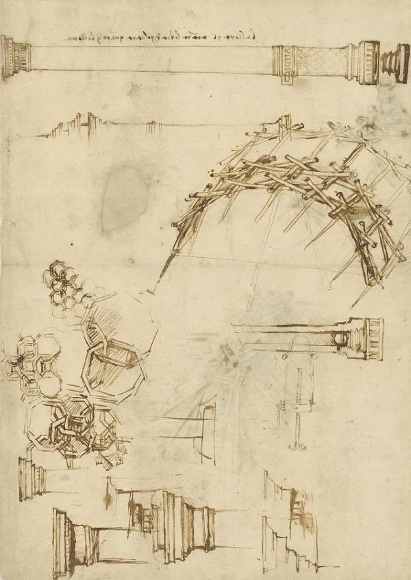

I also wanted to keep architecturally with the idea of self-sustainability so I wanted to design a self-supporting bridge that would negate the need for concrete mid-supports. I found that Leonardo Da Vinci's self-sustaining bridge would be a perfect fit for this type of design. This design transfers all of the forces through the interconnected beams to the two base beams allowing for all of the weight to be maintained at a point.  The design arches are high enough above the water to allow to fit within the DNR’s regulations.

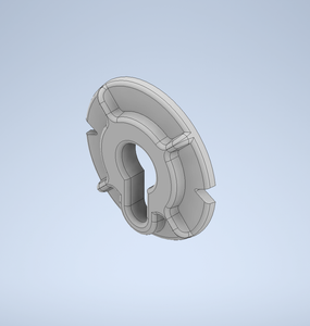

I designed this model in AutoDesk Inventor by starting off CADing each component of the bridge. I started with the supporting beams of the bridge and the hardware to interconnect them. I added the files into an assembly file and constrained them to one another allowing the base of my bridge to come to life. For the hardware, I used hex head bolts as that is what is used in the industry within this application, and chose the stainless steel option for the material type so the bolts would not rust over time. The washers are wood washers which allows them to grab into the wood making the bridge much more sturdy.
From there, I used the mirror tool to create the other half of the supporting structure. I designed one of the baseboards and used the rectangular pattern tool to create the individual planks. I finished the model by adding on the railings.
