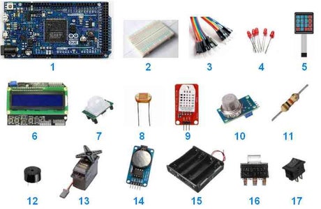

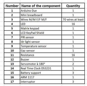

Step 2: Electronic Components
1- Arduino Due: this is the heart of our
project, we transfer inside it a program written in C language so it will capable of controling all the other electronic components.
2- Mini breadboard: Necessary to solve the problem of insufficient pins and space in the model and to avoid the purchase of another Arduino board.
3- Wires M/M F/F : Allow to conduct electricity to the desired location.
4- LEDs: Which will play the role of lighting inside and outside the house.
5- Matrix keypad: To enter the code, to open the door, activate and deactivate the alarm.
6- LCD KeyPad Shield: To display date, time, temperature and other informative messages. Also each push button plays a main role
7- PIR sensor : To detect the presence of movement when the alarm system is active.
8- ldr light sensor: it detects the degree of brightness outside the house. It is thanks to this component that the outdoor leds will turn on when it is dark and turn off when it is light.
9- Temperature sensor: Senses the temperature degree that will be displayed automatically on the LCD display.
10- Gas sensor: Measures the amount of gas in the house.
11- Resistance: Are all 220 ohm connected with the 16 leds so that they won't get burned.
12- Buzzer: To play the role of alarm. This component will automatically be activated when the motion sensor detects a movement or when the gas detector smells gas with a high quantity.
13- 180° Servomotor: One will open and close the door and the other will open and close the curtain.
14- Real Time Clock DS3231: this is the component that give us the exact date and time of today.
15- Battery support: one will power the arduino board and the other two will power the other electronic components.
16- ARM 1117 : Specially used to help the small 180° servomotor to be powered with 3.3 V.
17- interruptor: Ideal for controlling the flow of electric current to all electronic components.

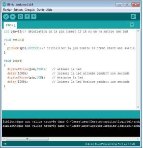

Once all the electronic components are properly connected to the Arduino board, a computer program must be downloaded to ensure proper communication of the system. To create any program, we must first download the programming tool by consulting the following link: www.www.arduino.cc/en/Main/Software, then write the code in C or C++ language.
Here is the code source for who want to do the same

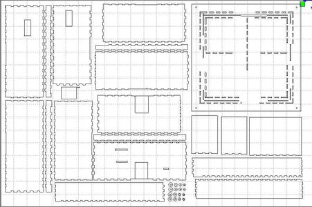

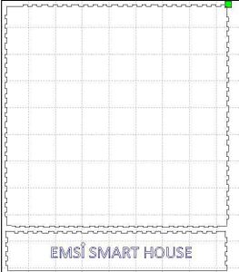

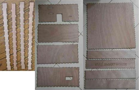

Step 5: Designing and Cutting the Model Using Inkscape and RDWorks
Step 6: Assembling the Wooden Model
