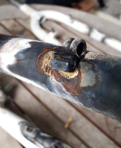

- Weldable slotted stop for cable management (Silva Art 111 slotted stop, ID 6,3 mm - x4)

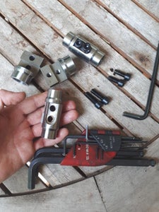

- Tube Couplers, those are used in rally cars, for splitting the roll cage when you want to access the engine. So here is the tricky part: you have to guess the inner diameters of the tube you are going to cut. On this basic tandem bicycle, the tubes have constant thickness all along the length. On expensive bikes, it is buttered. Welding with a blowtorch, with bronze rods, is quite forgiving. But still, the coupler should not float in the tubes.
- Cables Couplers, required for the rear brake and for the gears. These smart tiny things allows you to split the cables in two parts. Be careful though: it means that you have to see the cable (you do not want to split the sheaths).
- Soldering flux powder and bronze rods. The tube couplers are going to be welded with a blowtorch (though it *might* be done with arc welding but it is much, much more tricky since the bicycle tubes are pretty thin - I would clearly *not* recommend doing it that way).

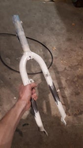

The two half-frames should be more or less of equal lengths including fork (not easy to separate), mudguards, racks… Check out the regulation of the transport system you want your tandem to travel with, use a ruler, do some drawings, print models… Take your time!
In this case, some paper models have been done: those have the length of the couplers and were glued to the frame. It is a good way to see what's going to happen. Also it helps cutting straight (yes that has been done with a metal saw, by hand).

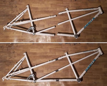

Please note that the tube couplers are aligned on a left/right position. As the tubes that have been cut are not parallel, it would be impossible to separate the 2 parts by "lifting" the rear part. So the tube couplers are set horizontally in order to separate the 2 parts by sliding them on a left/right movement.
See the picture with frame with and without coupler? Well look at the pairs of black screws on the bottom picture: that does not operate. Couplers are well set on the following step: screws are looking up and thus will allow the separation by this left/right slide.

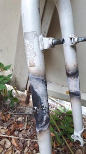

Step 4: Blowtorch Time
A strap has been used, it helps to maintain all the parts together but be very careful with the alignment: if the cuts are not perfect, tightening the straps will lead to misalignment. Use a ruler to check that the frame follows a straight line.
The tube couplers position is critical, you will have to clamp and/or tack those. Check if the 2 parts of the frame are sliding correctly before full welding.

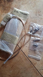

Step 5: New Brake/gear Stops
So, the brake and gear couplers are coupling the cables, not the sheaths! See the picture: on the top one can see the original Sheath Guide. Below it is the new Brake Stop. This means that before transformation, a sheath was going over the tube coupler. Now, this new Brake Stop means that there is an "open air brake cable" over the tube and it will be split thanks to a cable coupler.
Fun fact: brake cables of tandem bicycles are specific (because extra-long). With these cable couplers you will use standard cables (just two of them are required for each break/gear).

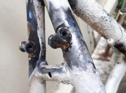

Step 6: Extra Solderable Stuff
When soldering, you are damaging the painting so it makes sense to add all your needs/desires before cleaning and painting the whole frame again. Extra bosses for a rear + fork racks and mudguards have been added. Also extra bottle cage bosses for putting stuff have been welded.
