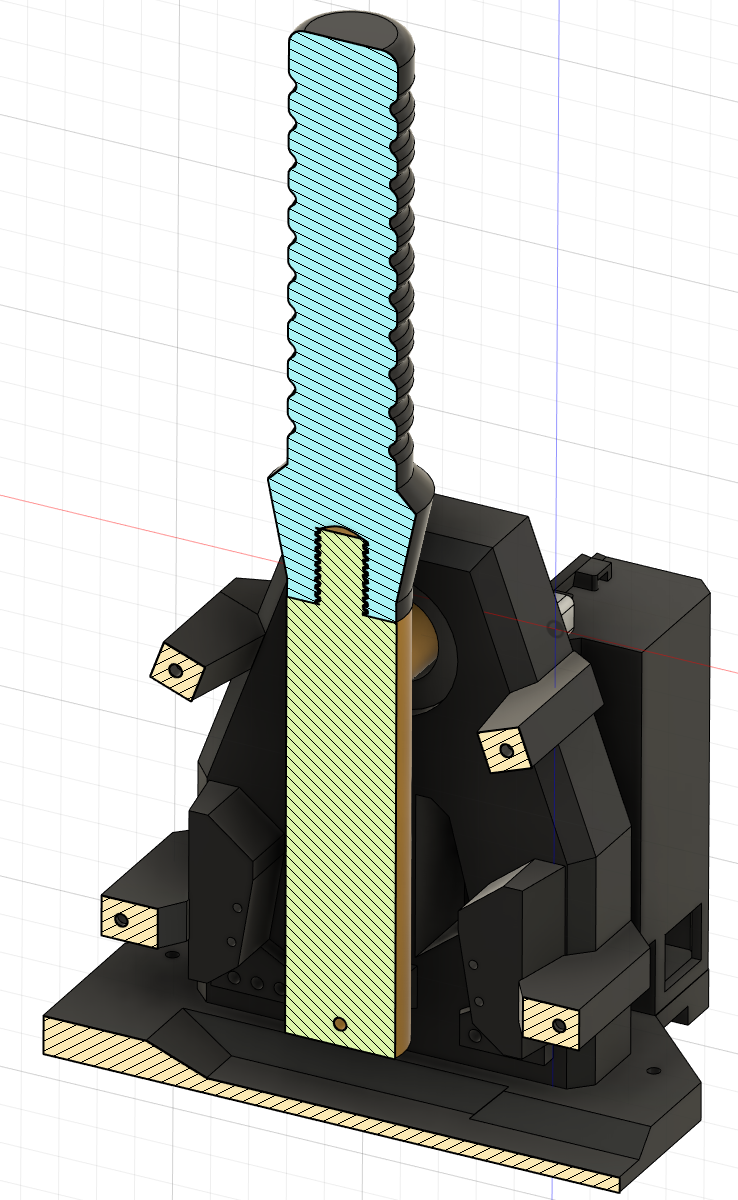

Step 1: 3D Drawing
TLDR: The model is available at Printables
Searching for a base:
I started my design by taking a look at what had already been done. Using an existing and available basis always helps with your design, it allows to learn by what other people have done and it will also clarify what its absolutely required and what you can ditch for other solutions that might work better for you.
If you search the web you'll see a bunch of different designs for this exact purpose. I based mine on a previous build by @uuild_294934.
I took this decision mainly because at the beginning I didn't know how I would want the mechanism to act and behave, and his design looked like it gave me multiple options to sense the shaft position, both using an analog sensor or digital switches.
Analyzing the gap between the base and the desired outcome:
Now that I have a starting point, its time to see what I need to change to make it accommodate my requirements.
- The shaft support/hinge is in direct contact with the support walls, the plastic rubbing on plastic will create some friction and some play that I don't really want to feel when I'm using the shifter, so I needed space for some bearings
- There is no end stop to limit the lateral play of the shaft, I will have to find some way to make it so that there is no chance for the shaft to move side to side.
- The shaft does not return to the middle position by itself since it doesn't have enough weight, so I will use magnets to make sure the action is precise enough
- The original handle was a little small, so I need a new handle aswell
Design, 3D printing and assembly
After defining the requirements, its time to start the development, for that I used fusion360 and printed everything in PLA.
The assembly is pretty simple, theres only a couple of points that you need to be careful.
- The bearings are press fitted into the wall slots (theres a small lip and the bearing should be pressed into that small lip).
- The magnet polarity is important, when you glue the them to the wall make sure you glue to the stick shift with the correct polarity, the magnets should make the stick want to center itself (the magnets should attract)
- To glue the magnets use glue that can be used with plastic, some glues might dissolve the plastic
The assembly order is simple, it should go something like this:
- Press fit bearings into walls
- Glue the magnets to the walls and stick
- Mount the micro switches into the wall
- Press fit the stick into the middle of the bearings, for both walls
- secure the walls with the M4 screws
- Screw the walls to the base
- Add the hinge covers
- Add the housing to the base
- Insert the PCB, connect everything and you should be ready to go :)
