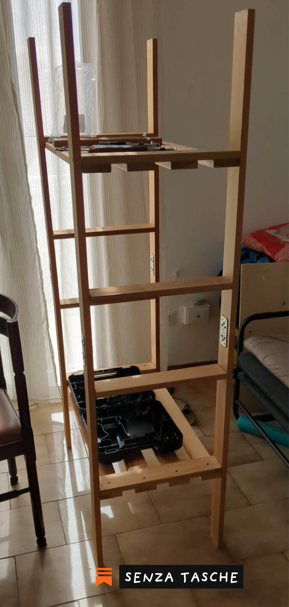

The shelf will be as long as the length of the slats, as deep as half a slat (for easy cutting) and as high as two slats stacked lengthwise. So 80 x 44* x 160 cm.
*(44cm deep -> 40cm cut slat + 2cm each perpendicular side into which it will be screwed)
Since the shelving unit is self-built, we can customize it based on what we already know it will contain: the shelves will be spaced as far apart as the tallest object that will then be on that specific shelf. Measure stuff you know you always have.
You can build a top shelf, I left it open for an easy dish drainer use. (see photo above)

Start by measuring carefully and cutting 4 slats in half with the hand saw, then cleaning the cut with sandpaper, starting from the coarsest grain and working your way to the finest. This will give you 8 pieces of about 40cm. Try to make them as equal as possible. Let's put them aside for now.

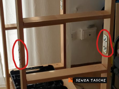

To build the columns, which will be the height of our shelf, join two slats lengthwise with the help of a small plate. Use 8 slats, joined two by two, to obtain 4 columns. The screws used are 15mm.
Holding them at 90°, screw four 40cm boards (that we cut at the beginning) to one column and then to the other one. To do this use the 50mm screws. You will obtain a ladder. Repeat the procedure obtaining two.
In order for the plate not to be visible from the front, the columns must be directed to the same side, so the plates will not be facing each other, but one will be inside the shelf and the other towards the wall. See detail in the photo above.
Step 4: Adding Shelves
Now you can make the shelves. On the short pieces of each ladder mark the position where the slats will sit. You can measure by hand or by spacing the slats using two boards placed on the 2cm side as a separator. In the photo up here I have recreated the method for an easier explanation.
Once everything is marked, screw down the slats using the 30mm screws. I suggest doing it upside down because it is easier to screw from top to bottom than the other way around, and then turn the shelf around, so the screws will not be visible.
Step 5: Conclusion
This is the pantry shelf today. It contains both our supplies and everyday stuff. It holds a lot of weight: kilos and kilos of pasta, jars of legumes and various cans, bottles of condiments, bags of flour, small appliances and the dish drainer. The shelf is not nailed to the wall but it won’t move by a millimeter. Renter-friendly. Stout. Perfect!
