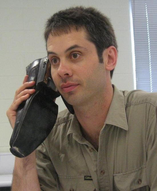

I had a blue tooth headset that came with my Sony Ericsson Z310i, but it resisted my attempts at disassembly, and didn't look like the microphone and speaker could be changed orientation, which I have decided is an important criteria. So I went to our local pawn broker and for the princely sum of AU$19 obtained a pre-loved Motorola H500 blue tooth head set. (They were very patient with this odd man who said he wanted a tiny head set or phone to put in a shoe).
The H500 head set had two advantages over the Ericsson one: (1) it looked like the speaker and microphone were on wires and could be moved; and (2) there were instructions on the internet to help me disassemble it without breaking it.
Okay, so now I had a nice little head set, and all I needed was a shoe to put it in. Fortunately our church op shop was open, so for the bargain price of AU$3 I got a nice pair of very swanky shoes.

Some digging away with a chisel and a precision screwdriver, and the help of a steel shoe last to hold the shoe still, you should have a shoe with a H500 shaped hole in the heel.
Make holes for the speaker and microphone. I organised for the microphone to peek out the side a bit, since it seemed like a good way to work it.
The big hole in the photo is for the H500 board and front cover (which I decided to retain so that the answer/hang up button would work without too much effort). There are two little holes nearer the top of the image to take the speaker and microphone.

Then plug it in and charge it up, and try it out!
As I mentioned before, the microphone on the H500 is so sensitive, you can hold the shoe any old way, up to 2 metres away and it will pick up the conversation with ease.
However, the speaker volume is a bit quiet, and you will need to position the shoe fairly well to hear the conversation. This will be even worse if you didn't adjust the volume to maximum before assembling the shoe.
