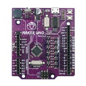

  • An Arduino Board
For this project, I used a leftover Maker Uno but you can use any board that is compatible with Arduino, has a 3.3V and 5V pin for the bluetooth module, TX and RX pins, and a few I/O pins.

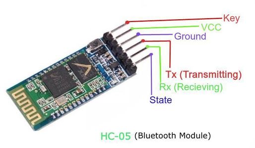

Step 2: Configuring the Bluetooth Module
Here, we'll rename the bluetooth module to Team A. To do this, we need to enter AT mode. Connect the bluetooth module to the Arduino board, following the step process and the connections from this link, or refer to the picture above.
Follow the instructions to change the name of the bluetooth module to: Team A (or whatever you would like to name your teams) and set a simple password.
Additional Notes:
  1. The EN pin is the same as the KEY pin
  2. If it does not go into AT mode, it helps to upload a blank sketch first, then go into AT mode.
If everything goes well, you should have sucessfully renamed your bluetooth module. Do this for all the bluetooth modules for each buzzer.
Disclaimer: I do not own the rights to any of these instructions. They were taken from here and here respectively.

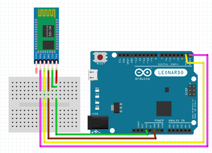

Step 3: Connect the Bluetooth Module
It's time to connect the bluetooth module to the computer.
  1. Connect the bluetooth module as shown in the connections below, and the picture above.
Bluetooth Module -> Arduino
5V or VCC-> 3V3
GND -> GND
Tx -> Rx (Pin 2 of Arduino)
Rx -> Tx (Pin 4 of Arduino)
  1. You can initialise any two pins as the TX and RX pins, but make sure that the bluetooth's TX and RX are NOT connected to the actual TX and RX of the arduino.
Bluetooth TX --> Arduino RX
Bluetooth RX --> Arduino TX
  1. The LED on the bluetooth module should start blinking!

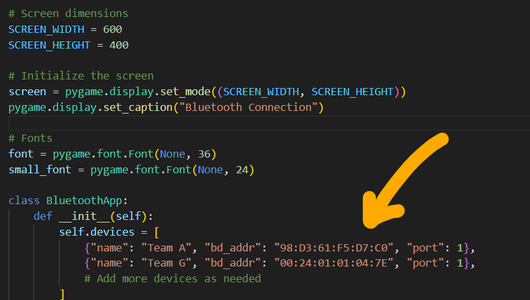

Step 5: Adding the Addresses of the Bluetooth Modules to the Code
In the GUI_final.py file, add in the addresses of the bluetooth modules that you will use in the dictionary. See the picture attached (its near the beginning of the file).
Follow the prexisting format that is in the code:
  1. "name" of your bluetooth module: Team A
  2. "bd_addr" is the address of your bluetooth module that you recorded in the previous step. 98:D3:61:F5:D7:C0 (this is an example!)
  3. "port" this is part of the bluetooth connection. Just leave it as 1.

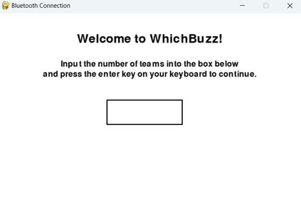

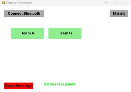

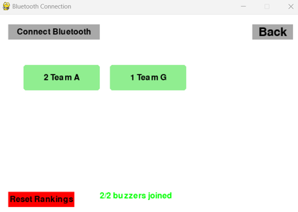

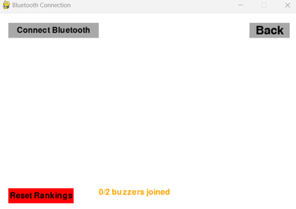

Step 6: The GUI for the Pop Up Message
This step is relatively simple. Just run the GUI_final.py code in the previous step - it should have your addresses of all the teams bluetooth modules.The GUI works as follows.
A window should pop up, saying: Welcome to WhichBuzz! Here, you just need to add in the number of teams/buzzers that are going to be participating. You can always come back and change this number. Once you have typed in the number of teams, press enter, and you'll be taken to the second page.
The second page has 3 buttons:
  1. Connect Bluetooth: Press this button (ensuring that the bluetooth modules are connected to your computer first!( See Step 4). If they're connected, the team names for each buzzer should appear (see the 3rd image).
  2. Reset Rankings: This resets the rankings (the numbers infront of the team names) on the buzzers.
  3. Back: Once pressed, this takes you back to the first page, where you can change the number of teams that will be participating. It will then update the second page.
That's it! Now, we'll look at recieving the data, so that the bluetooth modules know which buzzers are pressed...

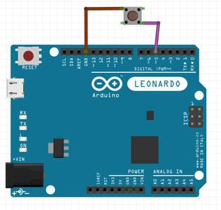

  1. Connect your Arduino Board to the computer and make sure you have the Arduino IDE installed.
  2. Connect the button like the picture shown above. On one side, one of the legs should be connected to ground, and the other to any pin you want. In this case, it's Pin 5.
  3. Download the button_code_debounced.ino file attached and load it into the board. To test if it's working, you can add: Serial.println("Beep"), inside the if statement: if(buttonState == LOW) {}. You'll see instructions on how to do this in the code itself.
  4. Open the serial monitor to view that it does indeed print this string each time the pushbutton is pressed.
