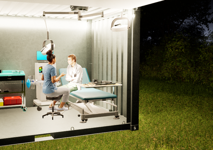

To provide the main lighting for the scene, I started to work on the interior of the shelter. As with my original outline, there are two LED light bars on either side of the shelter to provide light on the inside, as well as making the Red Cross symbols slightly emissive for easier visibility. Initially the LED bars were casting a little too much light on the scene, and because the container material was so reflective the light was too evenly dispersed for my liking. I raised the reflective index of the back wall material to cast a few more reflections for accuracy, and decreased the reflectiveness of the shipping container so the final images wouldn't be too noisy. I kept the temperature of the LEDs to a warm 4500K, to make the scene feel warmer and more friendly, rather than scary and sterile as medical offices usually are with their dull fluorescent lighting.

As I got ready to start the final renders, I set the parameters for how I wanted light to be rendered in the scene. I was faced with two options: real-time and path tracing. The first uses a game-engine style program to calculate the way light plays out in the scene, and while it can be much faster to render and simpler to manage, it's not as realistic. Path tracing on the other hand calculates light emitted from emissive sources in the model as millions of individual rays, bouncing off of different objects as they interact. Although the fans on my PC might have been loud enough to wake up the neighbors, path tracing was totally worth it. Above you can see the difference: the reflections of the bins on the floor, the glow of the Red Cross sign on the wall on the right, the higher-accuracy shadows on the figures. I set the amount of ray bounces calculated to two bounces, so that the final renders wouldn't be too washed out, and with that, I was ready to render!!!

This render shows an alternative configuration of the shelter, where it is used primarily for a patient waiting and diagnosis area.

I'm really happy with the way these renders turned out, and I think the lighting played a huge part! I think the way that the LED bars cast shadows out of the shelter onto the surrounding environment is awesome, and the path tracing really made it feel real. I know this isn't the longest tutorial, but I thought that it would be cool to share the lighting process for a rendering engine that gets a little less love, and for a unique architectural application. And I would love any suggestions on if there is anything I could improve, as I know I have a lot to learn and I'm sure with a little more expertise, these renders could be even more jaw dropping. Thanks so much for reading, and happy rendering!!!
