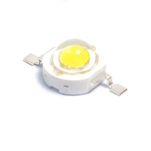

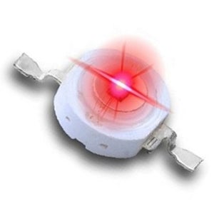

To illuminate the plants we use two groups of LEDs 1W: in a group there are three white LEDs, in the other group there are three red LEDs. So we can regulate the light intensity and its white and red components (according to the artificial season and the time of day).
The max value of current through each LED should be 350mA. This current value is too high for the digital outputs of the Linkit ONE so we need to use a more complex driver circuit with two transistors (remember that Linkit ONE digital output voltage is 3.3V with 3mA max). There are two independent driver circuits: one for the white LEDs and the othe one for the red LEDs.
Each circuit is driven by a PWM signal from a Linkit ONE's digital output (so we use two independent digital outputs).
The PWM signals regulate the intensity of the red and white light by their duty cicle.
The max current absorption of the circuit input is about 6.3uA (at 3.3V).
How to calculate R1 value
Supposing:
- Vcc = 12V
- Vcesatq1 = 0.5V (saturation voltage between collector and emitter of the Q1 transistor)
- Vfled = 3.2V (voltage drop for each white LED, while it is 2.4V for each red LED)
- Ifled = 0.35A
we have
R1 = [Vcc - (3 * Vfled + Vcesatq1)] / Ifled = [12V - (3 * 3.2V + 0.5V)] / 0.35A = 5.43 Ω.
The closest standard resistor value is 5.6 Ω.
If you want to increase the number of LEDs, you can add other parallel branches (each branch has a resistor and three LEDs connected in series). Of course, these branches increase the current absorption (each branch absorbs 350mA) from the power supply. For example, if you have three branches (nine LEDs), the current absorption is 3 * 0.35A = 1.05A.
NOTE: mount the LEDs on a heat sink in order to dissipate the high heat generated.

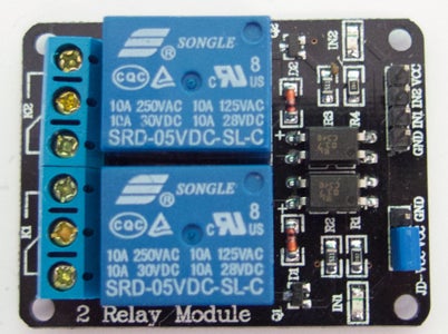

To control the flow of water we will use some solenoid valves controlled by some twin optoisolated relay modules.
Mainly there are two types of solenoid valves, one monostable and one bistable.
The monostable solenoid valve is fed with an alternating voltage while the bistable with a DC voltage.
In this project we will use bistable solenoid valves. The bistable solenoid valves have two stable states, one for the closed valve and one for the open valve. Feeding the solenoid, the valve opens and remains open even cutting off the power.
To close it we have to feed the solenoid reversing the polarity, also in this case by removing power the valve remains closed. The main advantage is a minimum electrical consumption, given that to open and close the valve it is necessary to feed it only for a few seconds, this allows to feed it using a battery.

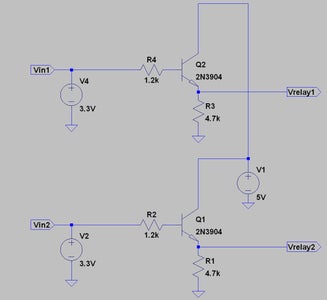

Each solenoid valve needs one twin optoisolated relay module. The two relay are properly driven by two Linkit ONE's digital outputs to apply a direct or inverse voltage to the solenoid valve, depending on whether you want to open or close the solenoid valve.
Each relay is driven by a transistor because the Linkit ONE's digital outputs can supply a little current (max 3mA).

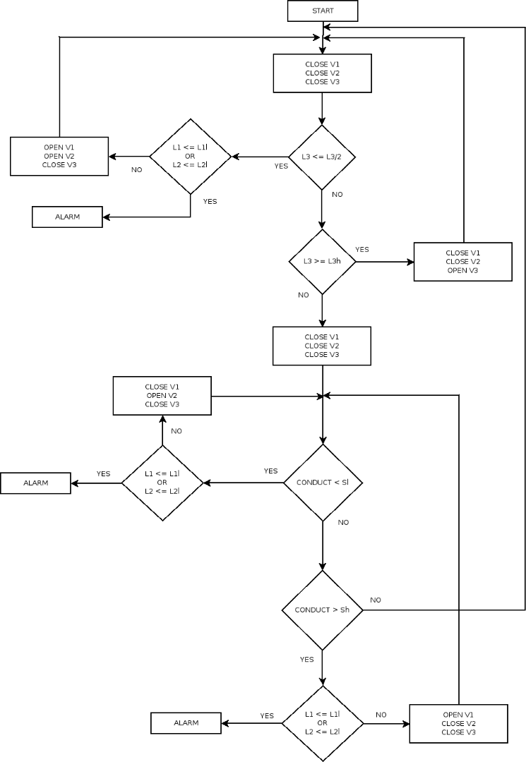

In the last step we show the complete project.You can find the Fritzing wiring scheme attached in a previous step. On the left side there is the lighting system with the LEDs and the transistors. On the center there are the voltage regulators and the sensors (for humidity and temperature, for the tank levels and for conductivity). On the right side there is the driving system of the solenoid valves (with the transistor and the relays). The solenoid valves control system is represented in the attached flow diagram. With this workflow we can control the solenoid valves in order to adjust the exact proportion between the water and the nutrient solution. It contains some check that inhibit the system when the water tank and the nutrient solution tank are almost empty. So when the solution is diluted little (conductivity > Sh) is opened the solenoid valve of the water tank while when the solution is too diluted (conductivity < Sl) is opened the solenoid valve of the nutrient solution tank. When these two tanks are almost empty, the system closes the solenoid valves and send an alarm using an SMS. When the level of the plant tank is too high, the system opens the corresponding solenoid valve. From the flow chart was derived the corresponding finite-state machine scheme (see attached picture) used in the sketch.
