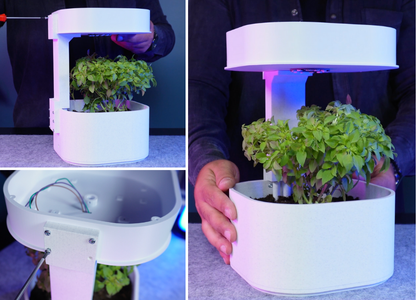

Hey friends, I love my plant but sometimes I forget to water it. As a maker, I thought, I really need to find a solution for this. This is my journey of turning a simple idea into a 3D printed self-watering smart planter.
The project includes:
  1. A 3D printed water tank, soil container, and electronics enclosure
  2. A smart watering system with a pump, spray nozzle, and water level sensor
  3. A Wi-Fi connected control board (Wemos D1 Mini)
  4. A mobile app for real-time monitoring, RGB LED control, and scheduling automatic watering

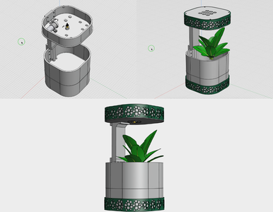

Step 1: 3D Design and 3D Printing
So I decided to design a self-watering smart planter. At the bottom there is a water tank, above that a soil container, and on top an electronics enclosure. All of them are connected with a vertical support piece that also hides cables and hoses. My biggest helper in this process was the Bambu Lab A1 Combo! With the help of my Bambu Lab A1 Combo 3D printer, I was able to design, print, and assemble everything into a working prototype. The printer made it possible to bring my idea to life with multi-color prints, easy setup, and seamless results. Want to start your own 3D printing journey? Check Bambu Lab here: https://tidd.ly/3Kt4fUK
All 3D models and Print profile, circuit schematics, source code, and components are available here:

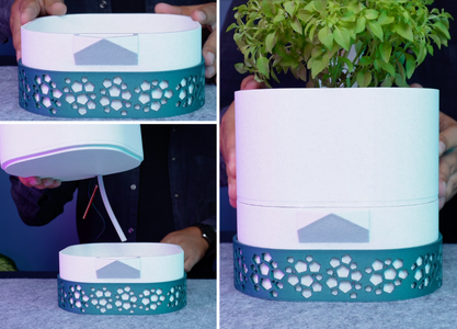

Step 2: Assembly 3D Parts
The prints came out strong and reliable. Still, to make sure the water tank is fully sealed, I applied a thin layer of epoxy resin inside it. The tank needs to dry for twenty four hours, so while it cures, let’s continue with the assembly.
First I attach the soil container to the vertical support using M three screws and nuts. This makes the structure solid and stable. Then I carefully move the plant into its new container, add some extra soil to support the roots, and the planting is complete.
Before adding the electronics, I install the RGB ring LED. After that, the electronics enclosure is fixed to the vertical support with M three screws. With the main parts together, I add a decorative frame around the electronics enclosure. Its mosaic like pattern makes the whole build cleaner and more stylish.

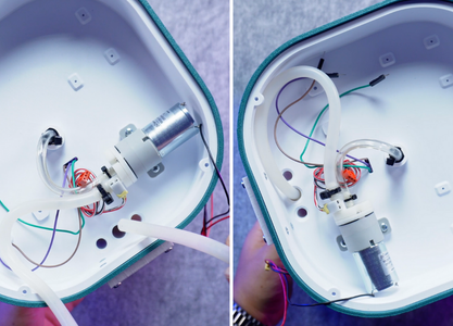

Step 3: Spray Nozzle and Water Pump
Next comes the spray nozzle. It has two modes, a tight pressurized jet for direct watering or a softer spray that creates a gentle rainfall effect over the whole plant. This way watering is both effective and elegant.

Finally I mount the water pump inside the electronics enclosure and secure it with screws. I measure and cut the hose for the nozzle, tighten it with a cable tie so it stays in place, and guide the inlet hose through the channel in the vertical support down into the water tank. Now the water system is fully connected.

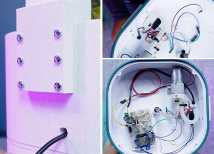

Step 4: Circuit
Now it is time to make this project smart. On the breadboard I am using a Wemos D1 Mini Wi Fi board, together with a voltage regulator and a MOSFET to drive the pump. For water level detection I added a simple analog sensor, extended with jumper wires.
Circuit Assembly
Follow these steps carefully to assemble your Automatic Plant Watering System. Double-check component orientation (especially diodes, electrolytic capacitors, and the MOSFET).

To power the system I connect a twelve volt adapter cable through the channel into the electronics enclosure. Then I place the breadboard inside and complete the connections for the water sensor, the LED, the motor, and power. Finally I close the top cover of the enclosure and secure it with screws.

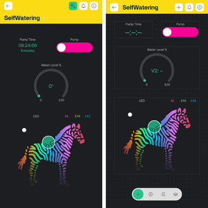

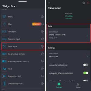

Step 5: Creating an App (Blynk Template Side)
For the control side I created a simple app using a free drag and drop tool. It shows the water level, controls the RGB LED, lets me set pump schedules, and even allows manual start and stop for watering.
This step covers everything end-to-end: create a Blynk template and datastreams, flash the firmware, understand what each part of the code does, and build the mobile dashboard. It matches the pins and virtual pins used in the sketch: V1 = Pump (Switch), V2 = Water level gauge, V4 = Timer Input, V3/V5/V6 = RGB (zeRGBa Advanced).

Step 7: Creating an App (mobile Dashboard Side)
6. Build the mobile dashboard (Blynk app)
  1. In the Blynk app select the SelfWatering device
  2. Add a Switch for manual pump control:
  3. Title: Pump, Datastream: V1, Mode: Switch, Off value: 0, On value: 1

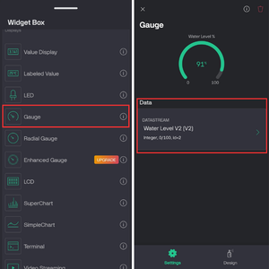

  4. Add a Gauge for water level:
  5. Title: Water Level %, Datastream: V2, Range: 0–100, Units: %
  6. Add a Timer Input for scheduled watering:
  7. Title: Pump Time, Datastream: V4, Time format: HH:mm:ss, set only Start Time (no need to allow start/stop input). Firmware will run the pump for PUMP_TIME once at the selected time and reset at midnight
  8. Add a zeRGBa for LED color:
  9. Enable Advanced Mode and map Red→V3, Green→V5, Blue→V6
Step 8: First Run and Verification
7. First run and verification
  1. Power the device; wait for Serial to show Wi-Fi Connected and the IP
  2. Toggle Pump (Switch on V1): ON → pump runs, OFF → pump stops
  3. Gauge (V2) updates about every 10 seconds with the water percentage
  4. Move the zeRGBa control; Serial should print “RGB -> R=.. G=.. B=..” and the ring color changes instantly
  5. Set Timer Input start a minute ahead; at that time the pump runs for PUMP_TIME and stops automatically; triggers only once per day
