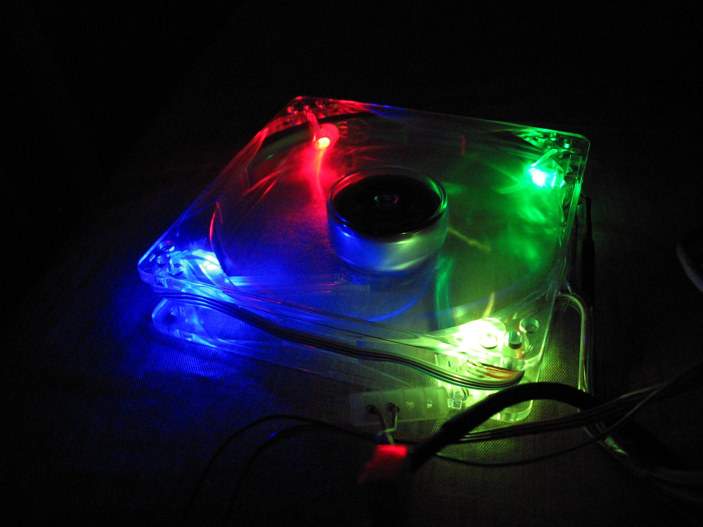

I will demonstrate the use of transistors by controlling PC fans from a computer's LPT (parallel) port. Then I will implement a simple form of PWM (pulse-width modulation) to control the fan's speed. This demonstrates the ability of transistors to use low-voltage, low-current signal lines (such as a parallel port or microcontroller IO line) to control higher voltage, higher current devices like motors (in this case, PC fans).

For this step, I'm using a PC fan (12V), a 9V transformer, and my transistor board to connect the fan to the PC. I have the base (white wire) connected to pin 2 on the LPT port, the collector (blue wire) connected to the fan's negative wire, the fan's positive wire connected to the power supply's positive wire, the brown wire to one of the LPT port's ground pins, and the other brown wire to the power supply's negative wire.

After double checking your connections to make sure that the LPT port is connected ONLY to the base of the transistor and ground, you can plug in the transformer or turn on the power supply to the circuit. The fan may or may not start spinning because some PC's or operating systems may leave the data pins on after booting. The fan should stop if you remove the white signal wire from the LPT port.
With everything connected, run the program you wrote in step 2. You'll have to use sudo and enter your password because port access is restricted. Start it by typing "sudo ./lptfan.o" (again typing whatever you called your program instead of lptfan) and hitting enter.
The fan should start spinning at full speed, run for 10 seconds, and then turn off.
