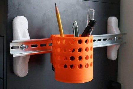

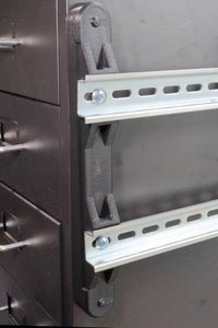

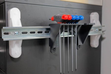

The only requirement for use is a metal surface large enough to support the project you want to mount. The pictures above show how we have used the brackets to support DIN rails projects and tools.

The initial bracket used an inline design, with the magnets placed in the same plane as the DIN rail. However, aligning the magnets vertically instead of horizontally proved more efficient for stability and weight distribution. The horizontally aligned bracket tended to slide down the metal surface slowly over time.

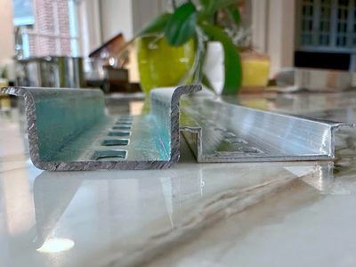

Step 4: A Word About Din Rails
There are many depth and material choices for din rails. We use IEC/EN 60715 – 35 × 15 for this project. Specifically, it is ASI PR006-1M Heavy Duty DIN Rail. It is 15mm deep. It is made of steel, not aluminum. This makes it rigid and able to span short distances without torquing.
The DIN rail can be cut to length with a hacksaw or a bandsaw with a metal blade.

  1. Attach the din rail to the magnetic mounts using screws and bolts.
  2. Attach the magnets. Place one magnet at a time, face down on a nonmetallic surface, and press the part onto the magnet. The face-down part of the magnet is flat. The other face has a curve to the top, which helps guide it into the hole.
  3. Screw the magnets in using woodscrews. Repeat for all magnets.
  4. The magnet and screw should be flush with the holder's body so they do not scratch the surface they are applied to.
  5. This step is not required but highly recommended if you attach the magnets to a surface you care about. Put a piece of gaffer or vinyl anti-skid tape over the While. While the tape will slightly reduce the magnets' holding power, it will help prevent scratching of the surfaces.
  6. Attach the magnetic mount to a metal surface.
  7. Test to ensure the din rail is secure and not likely to slip as weight is added.
  8. Add the components to the din rail.
  9. Test to ensure the magnetic mounts are secure and the complete assembly is firmly in place.

They also make great temporary tool racks.
