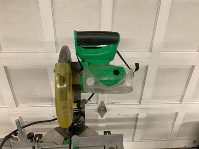

An electric miter saw.
A saw blade for Aluminum and Non Ferrous Metals

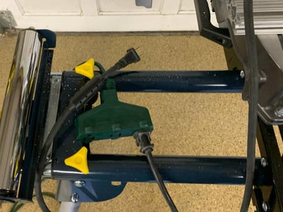

Install the non Ferris cutting blade on the saw. Make sure you true the blade. (We have a cheep miter saw dedicated to cutting aluminum so as to not have to do this step every time we do a cut.)
Set the saw up in a clean, open, area with enough open space to move freely around the saw. For large pieces you may want to set the saw up on the floor. Connect the saw to a shop vac or other dust collection system. Do not plug the saw in.

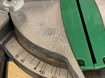

If your are going to do another cut, clean up the chips that are on working surfaces of the saw. This is good practice between every cut as a single aluminum chip can throw off the alignment of the cut.

Ok you're done with the cutting. Clean up everything. Give the broom a good workout. Vacuum off the miter saw. Vacuum off every nook and cranny on the miter saw. Turn the saw over and vacuum it again. Clean up the floor around the saw and whatever you were using as a saw support. Remember, sharp and conductive.
