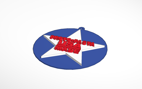

Step 1: Draw Your Model Using Tinkercad, Fusion 360, or Other CAD Program
If you don't already have an Autodesk ID (login), get one. This gives you access to many great "free" tools for creating 3D Printable models. You can use this to sign in to TinkerCAD, a super-easy-to-use cloud-based CAD software that runs right in your internet browser!
After logging in, click "Create new design". On the right-hand side of the screen, you will have several categories with various shapes to choose from. I started with the "Geometry" category and drug a "cylinder" from the right menu to the modeling space on the left. I then adjusted the size of the cylinder to get the desired diameter and height. In this case, I made a 140 mm diameter by 1 mm tall cylinder.
Repeat the process to create a "tube" and a "star". I made sure the star was taller (by 2 mm) than the cylinder. I repeated the same technique again in the "Letters" menu. I worked with one word at a time. You can select multiple features at once by holding down the shift button. I adjusted the size and height for "PROTO-PASTA" making sure it was 2 mm taller than the star.
When you are finished modeling, "save" your design and "Download for 3D Printing". Choose STL format to later import into your machine prep software. You can also share your design on Thingiverse. This model can be found at http://www.thingiverse.com/thing:539149

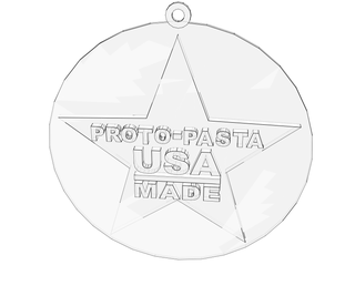

Step 2: Prepare for 3DPrinting Using Cura or Other Machine Prep Software
Now that you have an STL file, you can prepare your machine platform both digitally and physically!
Digitally, you will need to open your machine prep software, such as Cura. Cura is a common software used to generate g-code for our Printrbot simple Metal and other 3D Printers. You can see our chosen machine settings on the left hand side. We use a moderate resolution and are able to build a 3 color ornament in just 20 minutes. After loading your part onto the platform, you must save the g-code to send to the printer.
