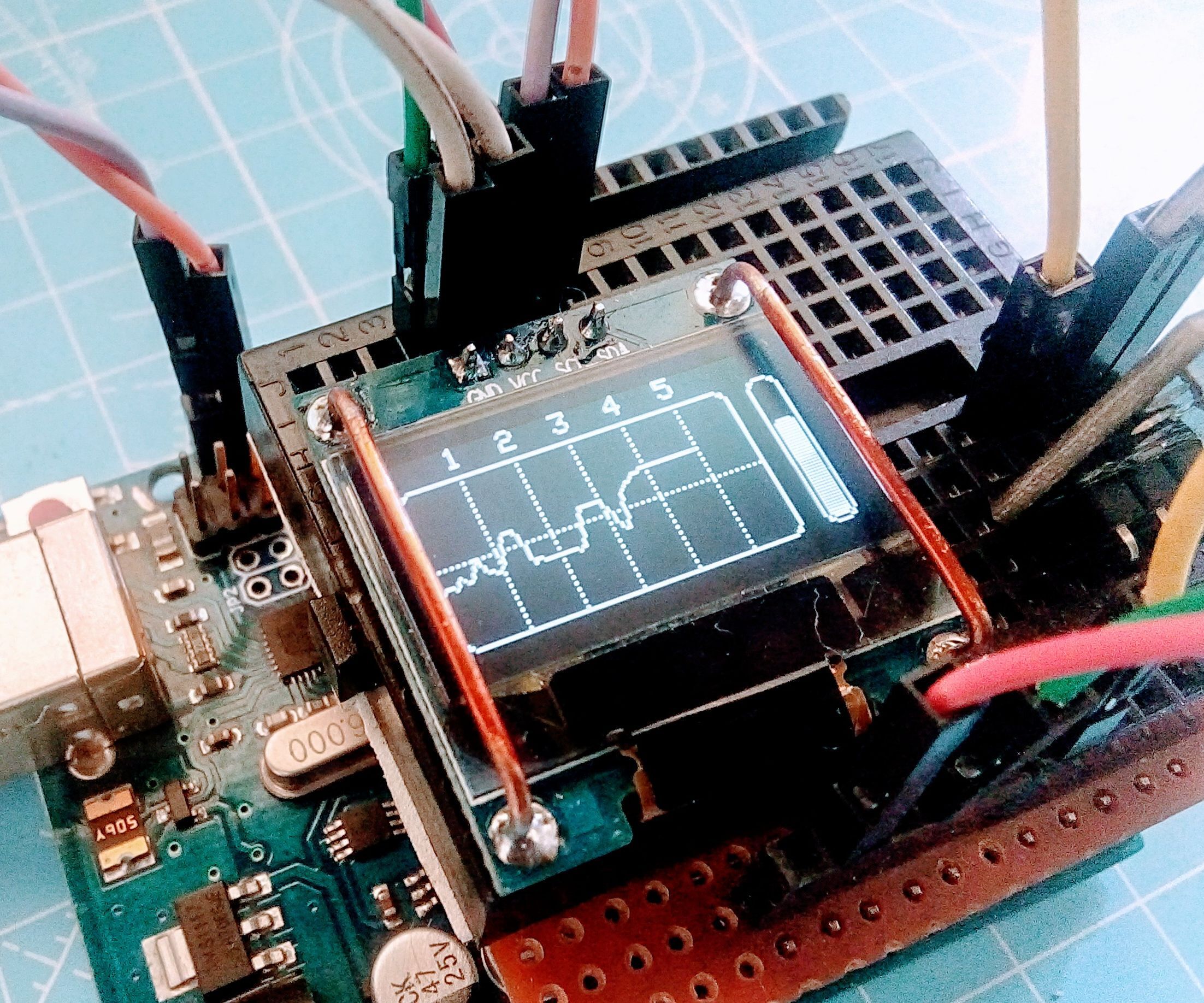

  1. Any arduino
  2. Any display (I used the 0.96" OLED, but you can use whatever you have, just make sure to put the right variables into the display functions of your display.)
That's it.
Step 3: The Code
Here ya go. It's pretty clearly commented, so there should be no problems. The libraries and init for 0.96" OLED is in the code. Replace it with your own display's if it it's different.
