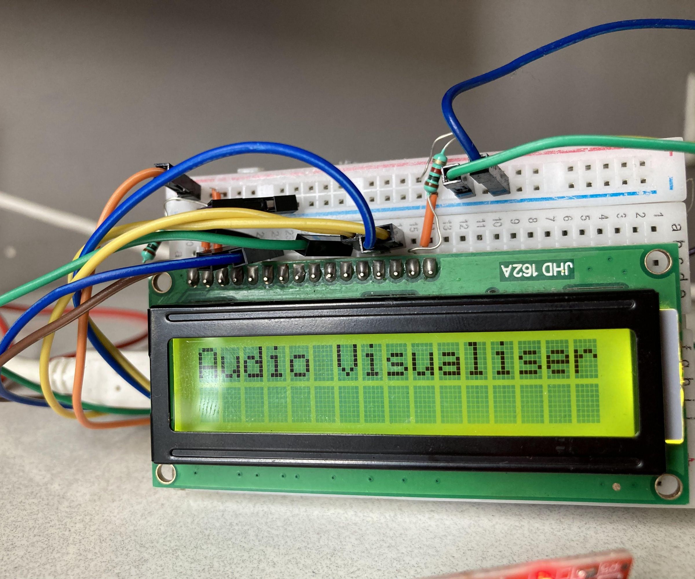

One LED and resistor are going to be connected in series. Make at least 12 series LED-resistor connections
Each LED-resistor connection will be connected to a digital pin on the Arduino UNO (one pin for each LED-resistor connection). Once connected, we need to connect our Sound Sensor. Connect the A0 pin to A0 of Arduino, + (or Vin) pin to +5V of the Arduino, and finally, the G (or GND) pi to GND of the Arduino UNO.
There are three GND pins in the UNO, two in the Power section and one in the Digital section. You can use any of the three GND pins.
There it is! Our hardware is done. The connection is really simple, so it won't take much time. Because of this simple connection, anyone can build and deploy this circuit.

Once you have uploaded the code to the Arduino, place the microphone (sound sensor) near a speaker and check the lights. If the lights are not glowing or glowing too much, do not worry! All of them can be fixed.
Open the serial monitor, located at the top right corner of the IDE. There you can see the analog value of the input you are receiving. If the analog values are less than the lowest reference analog value (here it is 250, see the code for understanding), the lights will not turn ON. However, if the analog values are higher than the highest reference analog value (here it is 260), then all the lights will turn ON.
The pins 2 - 13 are divided into pin groups of two, with each pin group having a fixed reference analog value. When the analog values are higher than the reference values, the pin groups will illuminate the LEDs, otherwise it remains OFF.
To adjust the analog values (not the reference values), turn the potentiometer knob present in the sound sensor. This potentiometer is used to adjust the sensitivity of the sensor.
In other words, we have to adjust the sensitivity to obtain the proper output.
