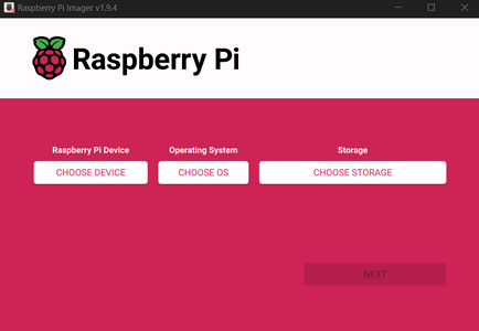

You would first need to install the Raspberry Pi OS imager from Raspberry Pi's official website.
For a more detailed instruction on how to set your Pi up, I recommend checking this video out.

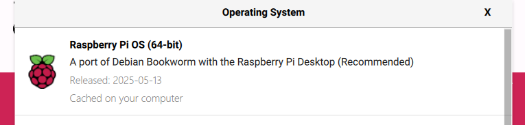

Just to further note, I went with the recommended option, which was Raspberry Pi OS 64-bit. I chose the one with desktop available since it has some of the libraries we would need already, like the picamera2 library.

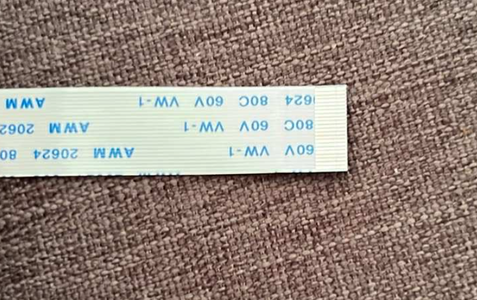

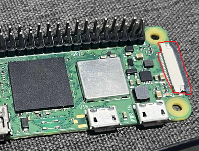

Start by connecting your camera into the Pi, if you are using the same board as I am (Raspberry Pi Zero 2w), you should see a small tab on right side near the power (PWR) port (as shown in Figure no. 1 of this step). Now, if you look at your camera module, there should be the shiny side at the end of the connector (as shown in Figure no. 2 of this step), you connect it to the tab on the Pi with the shiny side facing on the board (as shown in Figure no. 3 of this step).

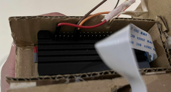

Connecting the Servo
For the camera to rotate, it would need to have a servo. Connect the Servo's red wire into the 5v pin, the brown wire into the ground(GND) pin, and the orange wire into GPIO pin 27 in the Pi (as shown in Figure no. 4 of this step). You may refer to this for the GPIO pin layout on your Raspberry Pi.
