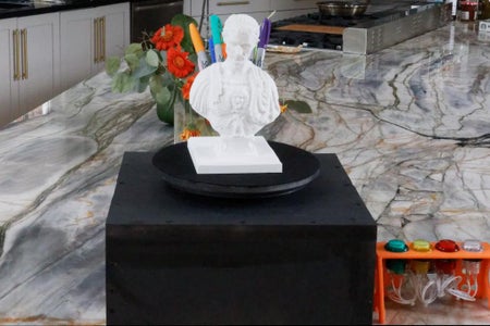

This is a rotating stage for photography or display.
The purpose of this project was twofold, first, to provide a rotating stage for photography, and second, to provide a rotating stage for a display stand. This was accomplished through software. If the software detects buttons, then it goes into photography mode. For example, the standard four buttons are set up, so there is an eighth degree of revolution in either direction from the two outside buttons and a quarter revolution from one of the inside buttons. The other inside button returns the stage to the initial starting position.
The stage goes into a continuous rotation mode if no buttons are found on the I2C bus. Each rotation takes approximately one minute.

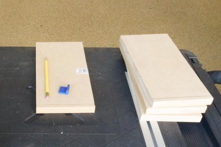

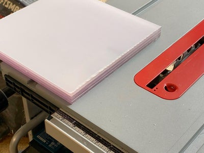

Step 1: Cut the Base Material
The base in this example is 1-foot square and seven inches tall. The material we are using is 5/8 inch MDF.
To make the sideboards.
  1. Cut four boards to 11 inches by 6 inches.
  2. Cut the top panel 12 inches by 12 inches.
  3. Mark the boards on one end, as shown in the picture. The marks are the location of holes that will be used as a drilling guide in the next step. In the example, we drew a line at 5/16 and then put marks one inch from each end, a spot at the halfway point of the line. If using 5/8 material, you can use the drill guide below to mark the line.
  4. Drill the screw guide holes in each board. The holes should be as straight as possible so use a drill press if available.

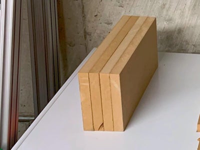

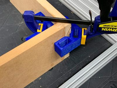

Step 2: Glue the Bottom Base Walls
Our method for assembling the base was first to make two sets of the sides, assemble them, and let the glue dry. Then we attached the two assemblies to make the bottom of the base. Be sure to be careful to match the heights of all the boards.
To make assembling the base.
  1. Using corner guides, place one of the pre-drilled ends of the board against a blank end of a board. Set the boards at 90° to each other using the clamps drill from the pre-drilled holes into the undrilled end of the board to a depth of about half an inch.
  2. Loosen the clamps and separate the boards. Apply glue to the end of the boards where they are to be glued using a wood screw, attach the two boards and re-clamp them. Wipe away all of the excess glue.
  3. Repeat steps one and two for the next set of boards.
  4. Allow the two sets to dry overnight. The following day removes the clamps.
  5. Glue the two subassemblies together using the same process and wood screws. Wipe away the excess glue. Allow drying overnight.

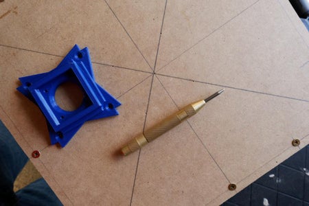

Step 3: Prepare the Top Base
Prepare the top of the box.
  1. Using a long ruler, draw a line from the opposite corners of the top.
  2. Measure the sides of the top and place marks at 1/4, 1/2, and 3/4 of the length of each side.
  3. Draw a line connecting the opposite sides of the top. You should now have a grid like the one shown in the picture.
  4. Use the drill guide or a ruler to mark a spot on each one of the horizontal lines at the center depth of the bottom side boards. These are your drill marks.
  5. Using a drill press or a hand drill with a guide, drill a hole at each drill mark.

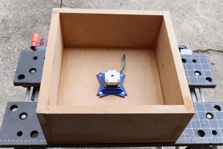

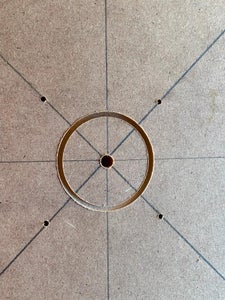

Step 5: Prepare the Top for the Motor Mount
Prepare the top of the box for the motor mount.
We will use the 3-D printed motor mount as a drill guide in this step.
  1. The 3-D printed motor mount has a V guide at the end of each arm. Place the guides over the diagonal lines running from corner to corner on the top of the box. The cross of the two lines should be visible in the circle on the motor mount.
  2. Using a pencil or a punch, mark the location of each one of the holes on the drill guide. You should be able to see the diagonal line running through each one of these.
  3. Using a 2-inch hole drill, cut a hole at the center of the box. The two intersecting diagonal lines are the center of the box.
  4. Using a drill bit smaller than the wood screws, make a hole at each one of the indents or marks you have made along the diagonal line. These holes should extend through the top.
  5. Using the mound, check the alignment on the underside of the box. Do not attach the mount yet.
  6. Using four M3 Panhead bolts, attach the NEMA 17 motor to the mount. Put the motor and mount aside.

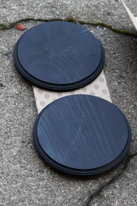

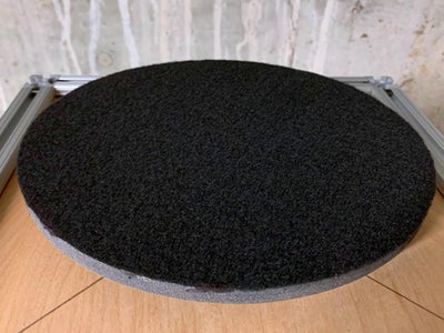

Step 6: Paint
Note: for a nicer finish, sand the outside of the base and remove as much excess glue as possible.
There are two pieces to be painted, the base and the stage. Clean the pieces and spray paint the outside of the base. The bottom and sides of the stage are painted. The top of the stage was not painted because it is covered in fabric in the next step.

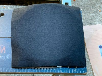

Step 7: Add Fabric to the Top of the Stage
The unpainted surface was sprayed with 3M Supper77 adhesive. The fabric was then placed over the adhesive and spread flat.
We tried two different materials, black felt and black flannel. They both provide a similar look on the surface. The flannel was easier to stretch over the sides. The flannel was cut flush with the edge. Both looked fine.
  1. Spray adhesive on the unpainted surface.
  2. Place material on the adhesive.
  3. Spread the material out, removing all wrinkles.
  4. Let dry overnight.
  5. Using a sharp X-Acto knife, cut off the excess material.

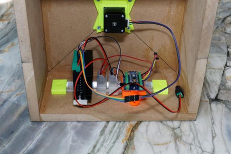

Step 11: Mount the Motor
Mounting the stepper motor.
From the bottom of the box, place the stepper motor mount so that the four holes on the arms are lined with the holes in the bottom of the box. Insert wood screws and tighten down. Turn the base over and check the alignment. The shaft on the motor will be very close to the center of the box.
Step 12: Mount the Electronics
We attached a din rail to one side of the inside base to mount the electronics in the base. We measured to ensure enough clearance to attach components from the top of the box to the top of the din rail. We also drilled a small hole at the bottom center of the side where the din rail was mounted to pass through the power cord and the I2C cable.
Additionally, we also installed two wood inset mounts to the outside of the base. This temporarily allows a piece of din rail to be mounted to the outside of the base. This din rail can then support the keyboard and other devices.

You should install felt pads to the corners of the base to protect the surface that the base will be placed.
We used threaded wood inserts to temporarily attach a din rail to the outside of the base to hold a switch array.
We have used a longer I2C cable to attach the buttons to a tripod while photographing. In the next project, we will show how to make a cover for the base.
