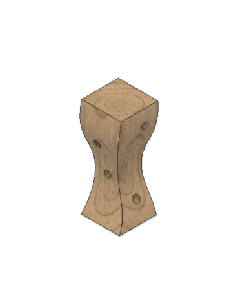

Step 3: Make a Curvy Cut
Now draw a wavy line on each of two faces, straddling the centerline. Stay away from the holes; and try to make the lines curving gently. Bear in mind that you will make a bandsaw cut along these lines; so don’t make the curves too tight or complicated. As long as it looks good to you it’s fine!

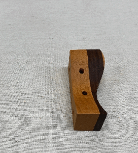

Next take the block to the bandsaw and make a cut along the first curvy line. The line serves mostly as a rough guide and does not need to be followed accurately. It is more important that you make this cut in one smooth motion, without stopping or forcing; even if you don’t exactly stay on your drawn line. If you stop you will end up with saw marks (or a notch) which you will have to sand out later on. Try to avoid that. The pictures clearly show that I don't know how to follow a line; but the end result is quite pleasing and the cut is smooth.
If you have some scraps you can practice making a smooth curvy cut first. Of course, a sharp bandsaw blade helps. I am using a 1/4” wide blade.

Once you have the two pieces, tape them firmly back together with packing tape or blue tape. Then make a curvy cut on the second face, again going smooth and steady. Here again, I'm terrible at following my own line but the cut turned out very well.
You’ll end up with four 6" long pieces. For fun, stack them together in their curvy form; i.e. put together the straight outside faces. This is how you would glue up curvy legs for a stool or table.
Using cherry wood I got some burn marks, so I sanded the curved faces to remove the burns and minor saw marks. If you do that don’t take off too much; you want the opposing faces to mate each other well. Also, keep the edges square.

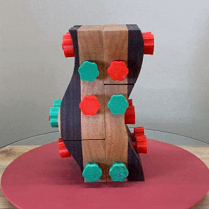

Step 6: Nuts & Bolts
To help with assembling the puzzle when playing with it I 3d printed some long bolts (1/4” diameter, 3-3/8" long, ACME thread, class 2G) and nuts. Wooden dowels/pegs would look better, but I had difficulty making them fit and hold in place. They were either too tight to insert, or too loose to hold the pieces together. You could use machine bolts and nuts, and ’spruce’ them up by attaching wooden knobs to the head and nut. You could also use a bunch of magnets. Maybe you have a better idea, let me know.
I choose red and green PLA for holiday cheer! You need twelve nuts and bolts. The unthreaded shank of the bolt is designed slightly smaller than 1/4” diameter to better fit through the drilled holes. Use the included stl files for your 3d print of the nuts and bolts. I 3d-printed with PLA at 0.16 mm layer height and 50% infill. The bolts are not very strong, so don't overtighten!

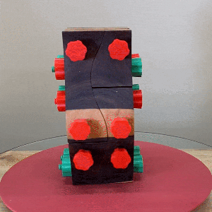

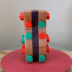

Step 7: Time to Play
The puzzle is not difficult, it's more of a tactile experience of building something. There are four 'solutions' to the puzzle: (1) the square block (like your original start piece); (2) the curvy post; and (3) & (4) curvy on two faces, straight on the others.
