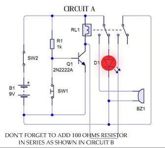

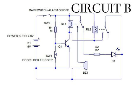

  1. 2N2222 - NPN Transistor (any npn will work fine) - 1
  2. 1k ohms resistor - 1
  3. 100 ohms resistor - 1
  4. DPDT relay - 1 (if you follow circuit - A)
  5. DPST realy - 2 (if you follow circuit - B)
  6. LED diffused red - 1
  7. 12 v piezo buzzer
  8. 9 v battery with snap
  9. duct tape *optional (step -4)
  10. magnetic reed switch with small piece of magnet *optional (step -4)
  11. Tools to work
If you got DPDT relay stick with CIRCUIT - A
If not... stick to CIRCUIT - B

Download the attachment and open with Circuit Wizard to simulate (circuit - B)
Step 3: If You're Not Interested in PCB Then Skip the Previous Step
Just connect components as shown in the diagram.

It will close the circuit when the door closed. this mechanism replaces the push to break switch in circuit
