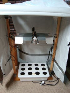

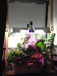

Here's my rendition of an inexpensive, successful little DIY Hydroponics system. I've no expertise or background in the area but thought this project info may be useful to others.
Having bought and enjoyed an AeroGarden Classic 6 LED system ($85 shipped Amazon Warehouse) wanted a higher volume setup but didn't want to pay too much for it. Combed the web for info and ideas, tossed in a few of my own and built this project. Very happy with the results. Though doing again I'd have gone a different way with the choice of lighting.
This Instructable just documents a project I built, through a BOM and photos, it does not cover basics or in-depth info available elsewhere and in other Instructables (e.g. "Hydroponics - at Home and for Beginners").

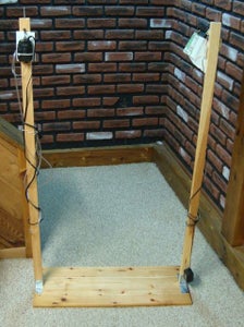

  • Wood base for box to sit on, longer than box & thick/sturdy enough for right-angle bracket screws. I used an old shelf.
  • Couple/few lengths of 1” x 2”s for two side posts & light hood bar. You could suspend LED Grow Panel(s) from wire, I preferred clamps.
  • Four 90deg bend brackets for sides of 1" x 2" to wood base mounting.

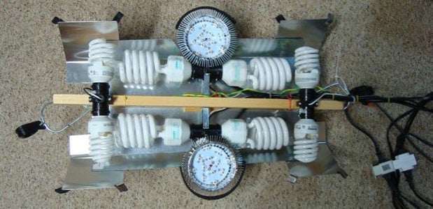

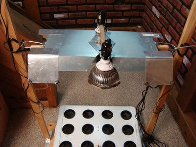

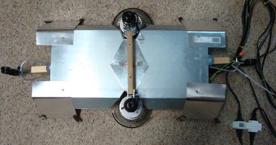

  • Lighting for light hood. Mine was a wacky culmination of lights I’d bought over time, so a bit of a mess and LOTS of work & time. Doing again I’d go for two 45W or so high-quality LED Grow light panels. Probably $50(?) each or more, don’t skimp here you’re having the audacity to try to emulate the Sun!.
  • Timer for light rated for much more than your light draw. Will want light on like 12 - 16 hrs a day depending.
  • Two Clamp Light with Reflectors, you’ll be using their spring clamps for light hood.

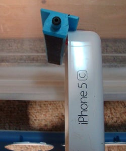

    Note: Have to weight air stone down or do something to keep it on box bottom (the way I did it, old iPhone box + zip ties to lid & air stone, was a time waster).
  • You can choose to trust a cheap check valve (if power goes out), I chose to mount pump high on 1” x 2” support (using gravity instead)

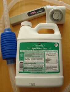

  • TDS Meter, I got $9 “Frentaly® Digital TDS Meter with Temperature Monitor” from Amazon.

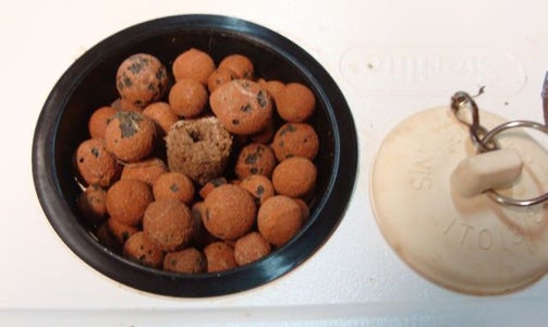

  • 3” Net cups / Mesh pots with good edge lips so they work with the 3” hole saw. I used 12 from a 24 pack (Amazon?)
  • 3” Hole Saw ($7 Amazon). And something to cut H2O / nutrient fill hole.
  • Some kind of hydroponics nutrients, I use Miracle-Gro AeroGarden Liquid Nutrients (1 Quart, $28 Amazon) because we’ve an AeroGarden, its PH buffered, seems to have nice nutrient coverage. It’s the only thing I use other than water. I shoot for maintaining 800ppm - 1000ppm.
  • Expanded Clay Aggregate Pebbles, 2lbs ($10) just did my 12 net cups.
  • Some way to suspend seeds until they root into Clay Aggregate Pebbles. I use Miracle-Gro AeroGarden Sponges, 50 for $18 from Amazon (again, we’ve an AeroGarden as well)
  • Sink stopper for water adding hole.

  • Aquarium Siphon Cleaner Water Change Vacuum ($5 eBay). Need to change H2O now & then.

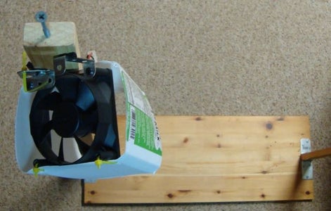

  • Little, low volume circulation fan. I used an old 12V PC fan and old 12V DC adapter. This helped circulate the heat from the light hood, raising the plant area temperature from basement's 55F/60F to about 70F.

Lots of photos. Again doing over I'd go with large square/rectangular high-quality LED grow lights. My light hood was an iterative process representing way too much work, using mostly florescent bulbs that don't last forever and took some wiring (hence the dedicated smoke alarm above this thing:) but the plants do like it.
