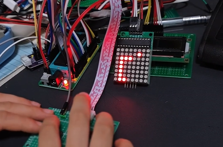

Snake, a classic, nostalgic game, is a must-write program for microcontrollers.
The 51 microcontroller minimum development board is used, and it is controlled by 8-bit self-made independent buttons. The microcontroller chip is STC89C52RC, and the crystal oscillator is @12.0000MHz. The 8X8LED dot matrix screen module is driven by MAX7219, which contains an automatic scanning circuit. You only need to send the data to be displayed into the chip register. It is very easy to use and recommended.
STC89C52RC
51 microcontroller
crystal

3. Movement and display of the snake
The dot matrix screen has 64 dots, and one byte can control 8 dots. A total of 8 bytes are required to store the data to be displayed. Define a display buffer array DisplayBuffer to save the data to be displayed. After the snake moves, or the snake eats food and produces new food, the data needs to be updated to the display buffer array DisplayBuffer, and then the data is written to the register of the MAX7219 chip. [The code also defines an intermediate buffer array MiddleBuffer (update the data to MiddleBuffer first, and then combine the 64 0 or 1 data in MiddleBuffer into 8 bytes). In fact, you don’t need to define this array. You can directly update the data to the display buffer array DisplayBuffer through operations such as AND, OR, and shift.] At the same time, the data in the array SnakeBody that saves the snake body data must also be updated synchronously.
4. Detection of the snake head hitting the wall and the body
Wall collision detection: If the data of the new snake head in the array SnakeBody after the move is less than 1 in the ones digit, less than 1 in the tens digit, greater than 8 in the ones digit, and greater than 8 in the tens digit, it means that it has hit the wall. The game is over.
Body collision detection: If the data of the corresponding bit in the cache array of the new snake head is 1, it means that it has hit the body. The game is over.

4. Main function
by Gan Tengsheng@20241202
Effect view/operation demonstration: You can search "Gan Tengsheng" or "gantengsheng" on B station to view
MCU: STC89C52RC
Crystal oscillator: 12T@12.0000MHz
Peripheral: self-made 8-bit independent button, 8X8LED dot matrix screen (MAX7219 driver)
Principle analysis: https://blog.csdn.net/gantengsheng/article/details/143581157
Operation instructions:
(1) Self-made independent button version
K7 K2 Up: K7
Down: K6
K8 K5 K4 K1 Left: K8
Right: K5
K6 K3 Start/Pause/Continue: K1
Return: K2
(2) Puzhong development board matrix button version
S1 S2 S3 S4 Up: S10
Down: S14
S5 S6 S7 S8 Left: S13
Right: S15
S9 S10 S11 S12 Start/Pause/Continue: S16
Return: S12
S13 S14 S15 S16
