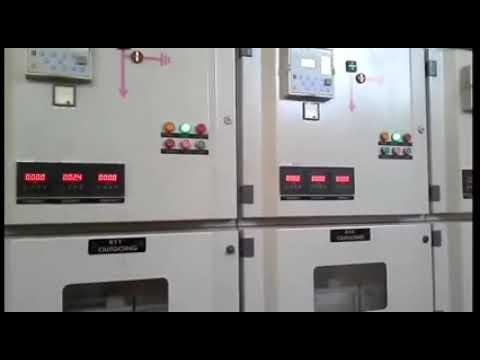

In this study article, I will examine the feasibility of employing a magnetic lock to secure medium voltage transformer rooms from theft, because they are positioned outside without guards and their exposure to theft has a detrimental impact on the quality and continuity of electrical supply.
The system will be constructed on the concept of the Internet of Things, thus the process of opening the electrical transformer rooms will be through a control room with a graphical interface that allows the operator to search for the transformer room to be opened.
This article will also provide the programe code and electronic circuit design in an open source way, as well as the specifications for the transformer room door and ventilation apertures.
