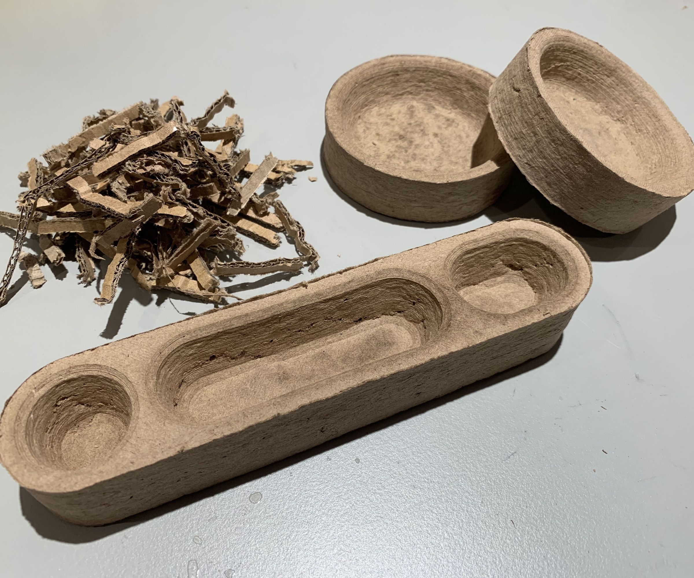

Step 1: Printing the Molds
Print all three parts in PLA or ABS at .1mm-.2mm layer height with 10% infill and 3 shells.

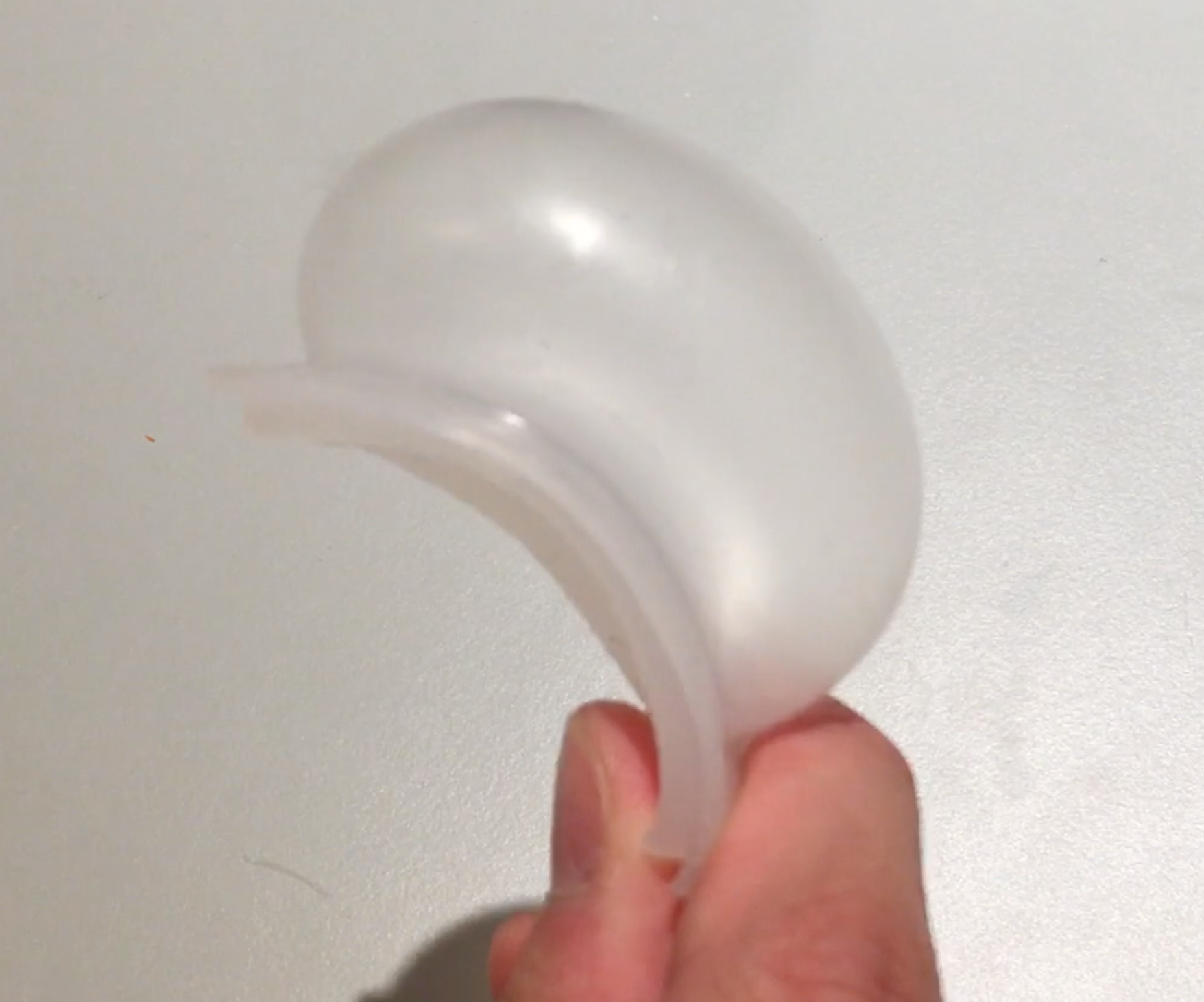

Step 2: Casting
Press the mold block into the slot in the mold as shown in the pictures. Mix up a small amount of Ecoflex 00-30. It is a 1:1 mixture, so be sure to have an equal amount of both liquids when mixing. Pour the mixture into the mold and let it cure for 4 hours.
Step 3: Demolding
Remove the mold block from the mold and carefully pull the cast out of the mold. It is best to pinch the tips of the gripper with your fingers and pull it out (remember to have patience at this step).
