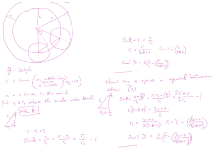

 For the calculated parameters, start by making the circular side as large as possible given your sheet size and margin, then the size of the tray sides can be calculated by fitting the number of trays you want around the circular side, to as large as possible, but staying within the side-circle, with 'Spacer' between them. Then the width of the trays can be calculated using the size of the tray sides and the height of the tray. After that, the length of the tray comes from subtracting the stand and side thicknesses (along with the spacing between them) from the maximum dowel length.
MaxDia:  min(SheetLength; SheetWidth) - ( 2 * SheetMargin )
DiaSides: MaxDia
RadiusSides: DiaSides / 2
ExtTraySideOverMainSide: 2 * Thickness
CtrSideToTrayDowel: ( 2 * ( RadiusSides + ExtTraySideOverMainSide ) + Spacer ) / ( 2 * ( sin(( 360 / ( 2 * NrTrays ) ) * 1 deg) + 1 ) )
DiaTrayEnds: 2 * ( RadiusSides + ExtTraySideOverMainSide - CtrSideToTrayDowel )
ZOuterDimTray: DiaTrayEnds * cos(90 deg - acos(YOuterDimTray / DiaTrayEnds))
MainDowelLen: MaxDowelLen
TrayDowelLen: MainDowelLen - ( 2 * ( ( 3 * Thickness ) + Spacer ) )
XOuterDimTray: MainDowelLen - ( 8 * Thickness ) - ( 4 * Spacer )

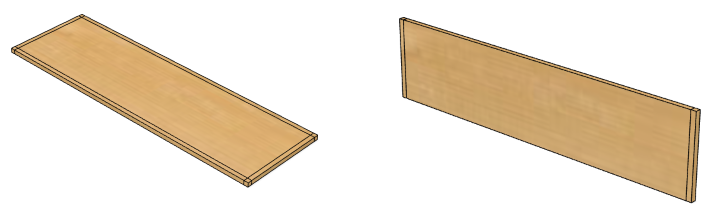

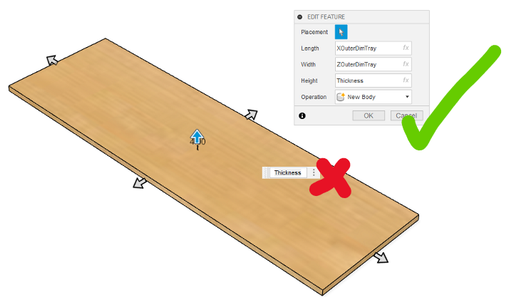

Start with the tray. Using the Create>Box option, start with one corner at the centre of the design space and drag it towards the bottom-right, so the values will be positive. [I may have been missing something, but I had to type the parameter names into the dialog box rather than at the drawing, otherwise if you come back to edit the feature later, only the final value is there, not the parameter name, which means if you change the parameter, expecting it to change all related parts, that doesn't happen unless you originally typed them into the dialog box.] After creating anything, always rename it in the 'Browser' to make it easier to keep track of later.
Step 3:

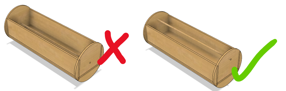

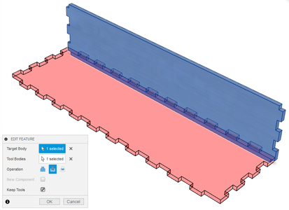

After creating the tray front and back in the same way (making sure they overlap the base), move the base up a little (Modify>Move) to make sure the tabs aren't at the bottom of the sides, [I used the Thickness parameter for this] then use the Cylinder option to create the tray ends, and the dowel. To get the dowel placement right, use Construct>Axis Through Cylinder/Cone/Torus, to put a constructor at the centre of the tray's side, then move it up by half of the tray's height (YOuterDimTray/2).
[On my first attempt at this, I put the tray dowel right in the centre of the tray's side, which was a mistake. Luckily I'd cut and built only one tray before realising it would overbalance as soon as something was put in it! So, I had a re-think after that, I wasn't sure if the trays would pass each other if they were hanging below their pre-calculated positions, but it turns out that isn't an issue - as long as the dowels are still in the same positions on the side-circle. It then looks like a Ferris Wheel (which now makes much more sense).]

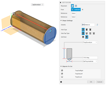

Since the dowel-holes here are going to be axle-holes, they need to be formed separately (as opposed to using the dowel as a cutting tool) to give the dowel room to move. [I added 0.5mm to the dia. of the dowels to get the axle hole's dia. but 0.25mm would probably have been sufficient] Do some test holes in a scrap piece of your material to gauge the size in which your dowels will turn easily without moving about too much.
 Make sure you expand the 'Objects To Cut' drop-down, and make sure it will only be cutting through the objects you want it to.

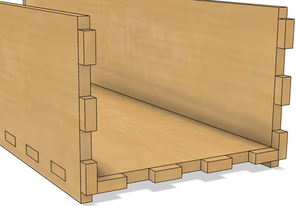

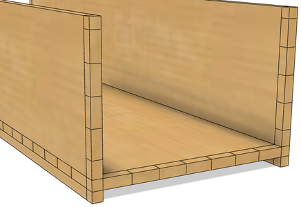

The next stage was to start on the tabs. This is where the pre-calculated parameters really come into their own. Use Construct>Offset Plane and offset it from the inside of the tray-end at the origin, by 0mm. Then create as many more as you need to get all the way along the tray, always offsetting from the previous plane by XTabWidthTray. If the calc's worked out, the last one created in this way will match up with the inside of the other end of the tray. Select the first plane in the browser, then hold shift and select the last plane, then left-click on the name of the top one and rename it something like 'XCutPlanes' (all those selected will be renamed with incremental numbering). Without changing the selection, right-click on one and select 'Create Selection Set'. Name the selection set the same, and then hide them (press 'V' to hide/show selected objects).
Repeat in the same way for each of the remaining two dimensions (make the inner tray side (front or back) one starting point for ZTabWidthTray, and then make the top face of the base the last starting point for YTabWidthTray). This is the most tedious part, but it's worth it.
Select the tray base, front, and back, then choose the tool Modify>Split Body. In the dialog box click Select for the Splitting Tools, and select the first and last of the XCutPlanes, tick Extend Cutting Tools, and click OK. Repeat with the tray-base alone and the first and last of the ZCutPlanes.
They should look like the images above.
Step 6:
 Now select the two end pieces of the base, and use all of the ZCutPlanes to split them up. Select the two side pieces of the base, and split them using the XCutPlanes. Finally select the four end pieces of the two sides and split them using the YCutPlanes.
 You'll end up with the first image above, and then you can select every other tab (click on one, then hold shift and click on the others), then right-click and select 'Remove' until you have the second image above. At this point it's important to realise that the sides do not have the tab-holes even though it looks like they do in that second image.
Step 7:

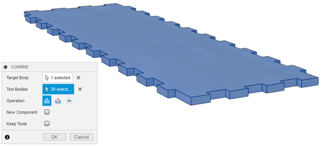

Now re-join the tabs to their respective parts: Choose Modify>Combine, select the base, and then the tabs surrounding it, make sure the Operation is 'Join', and 'Keep Tools' is de-selected. Then hit OK.
Repeat with each of the sides.
Step 8:

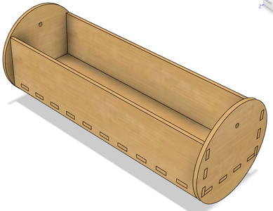

The final step for completing the tray is to cut the tab holes in the sides and ends. Start by choosing Modify>Combine, with a side selected as the Target Body, and the base selected as the Tool Body. Make sure the Operation is Cut, and that Keep Tools is selected. Hit OK. Repeat this with the other side, and then the ends - select an end as the target, and the base+sides as the tools.
Your tray is complete!

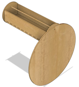

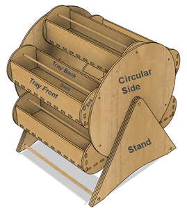

Step 9: Circular Sides

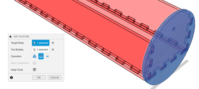

For the sides, create another cylinder, this time centred on the tray dowel, with the usual thickness, and a diameter of DiaSides. Move it downward by CtrSideToTrayDowel, and away from the tray's end by Spacer. Put a constructor at the centre with Construct>Axis Through Cylinder/Cone/Torus (selecting the face of the outer edge of the side for this). Then use that constructor as the centre of a new hole. Just as the previous one, except for the size - DiaCtrAxleHole.
Select every part of the tray, especially the dowel, and then choose Create>Pattern>Circular Pattern. Click on the axis selector and then use the axis constructed earlier. Make sure Distribution is set to Full, and set the Quantity to NrTrays.
When you hit OK, you'll have the trays distributed around the side, but they will need to be rotated around their dowels if you want them to look as if they are hanging correctly (it only affects the appearance of the design, and has no effect on the outcome, so you could leave them as they are if you like).
Now, select the side, and open Modify>Combine. This time you'll be choosing the tray dowels as tools, and cutting into the side (remember to have Keep Tools ticked).
Create the centre dowel now, using the same axis and the parameters DiaMainDowels and MainDowelLen, then move it by XMoveMainDowel, so it looks like the second image above.

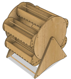

Step 10: Stand

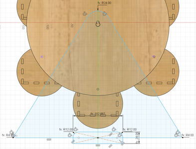

For the stand, we could just use a block, but I wanted something with a bit more shape to it, so started with a sketch.
First select everything we have so far, and choose Modify>Move, Select the 'Point to Position' option, and select a point at the top centre of the centre axis of the nearest side (it'll snap to this when you get close). Set X,Y, and Z to 0, and hit OK.
Now click on Create>Create Sketch, and choose the YZ Plane as the sketch plane. Turn Snap on in the Sketch Palette dialog, and choose Create>Line. Click on the bottom left tray dowel, the top centre tray dowel and the bottom right tray dowel, then press the Esc key so you have a pair of lines like an arrow head. [Now a part that had me baffled for the first few minutes.] You need to remove the constraints from the end-points of those lines, or you won't be able to move them later. Right-click on one of line end-points and select Delete Coincident, repeat for each of the three points.
Next to get that nice rounded top, choose Modify>Fillet, select both lines, and drag the top of the fillet until you have a shape you like. In my case I changed the value to 6*Thickness. Notice that this also gets a new point added at the centre of the rounding. Now select all three points and choose Modify>Move. Use the 'Point to Position' option, click on the Point box in the dialog, and choose that top centre point as the start point. Set Y to 0 (X and Z should already be 0) to place the curve in a nice position around the centre axle.
Now move the two bottom points individually. Select the bottom-right one, Modify>Move, Point to Position, choose the point itself as the Point, then move it to a position you like the look of, or use Y = -CtrSideToTrayDowel - DiaTrayEnds - ExtTraySideOverMainSide - ( 6 * Thickness ); Z = CtrSideToTrayDowel + ( DiaTrayEnds / 2 ) + ExtTraySideOverMainSide + ( 3 * Thickness ). If you choose your own position, take note of the values for the next point. Repeat the move for the bottom-left point, but use the negative of Z. [ Z = -CtrSideToTrayDowel - ( DiaTrayEnds / 2 ) - ExtTraySideOverMainSide - ( 3 * Thickness ) ]
Now create a line between the two bottom points. You can take the edge off the resulting corners using the fillet tool if you like. To make a space as a hand-hold at the bottom, use Create>Rectangle>Center Rectangle. If you hover near the centre of the bottom line, it will show a triangle next to it when you can snap to the centre of the line. Make it whatever size you like (you can safely ignore the half that appears below the line) and fillet the top corners.
If you now click within the main sketched shape, it will select the shape we need, and you can then click on Finish Sketch. Next choose Create>Extrude, type Thickness into the Distance box, and make sure that the Operation is set as New Body. Once you have the new body, move it away from the circular side by Spacer.

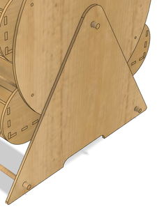

Select the main dowel, and choose Modify>Move\Copy, make sure Create Copy is selected, and choose Free Move as the Move Type. Drag it towards the bottom left corner of the new body. Once it's in a position you like, select the new dowel and choose Create>Mirror. For the Mirror Plane choose the XY Plane.
Finally, select the stand body, and choose Modify Combine, select the three main dowels as the Tool Bodies, and select Cut as the Operation, making sure that Keep Tools is ticked, then hit OK.
