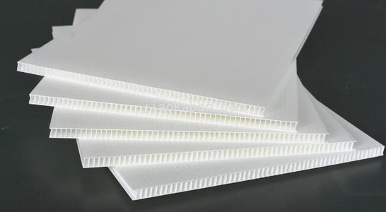

  1. The key concept is a reversible structure: flip it one way, it's a tent; flip it the other, it's a sunshade. I imagined using double-layered PP plate sheets because they are lightweight, waterproof, durable, and environmentally friendly—with just the right balance of stiffness and flexibility. Semi-transparent white material blocks direct sunlight while providing soft, comfortable diffused light ideal for reading.

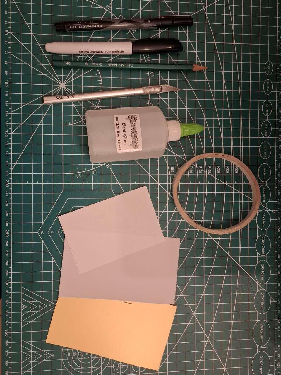

1,60 pre-cut white paper strips (1x8 inches):3x20=60 pieces,
2,Stapler
3,Scissors
4,Utility knife

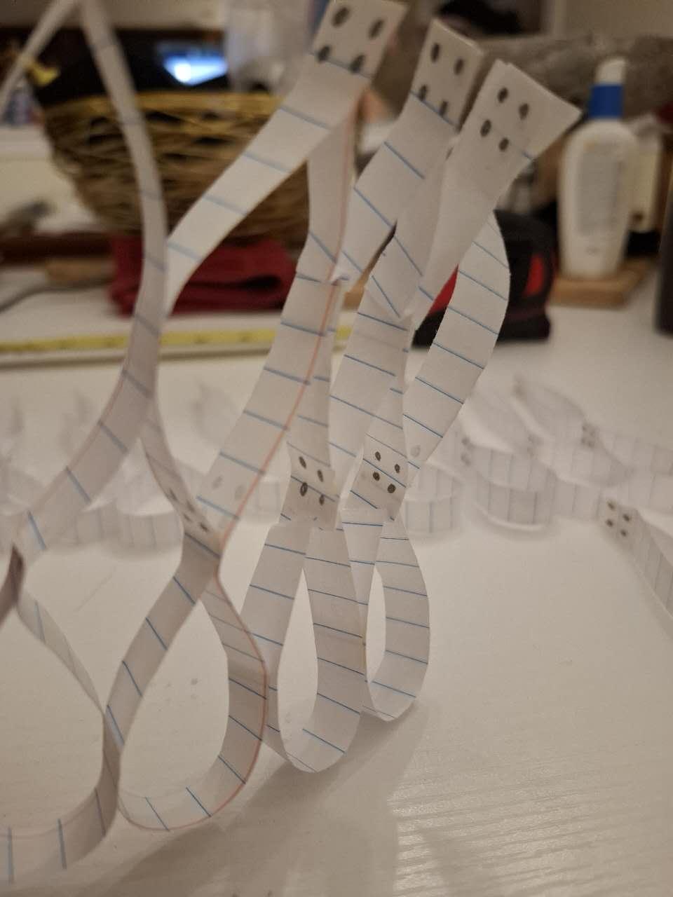

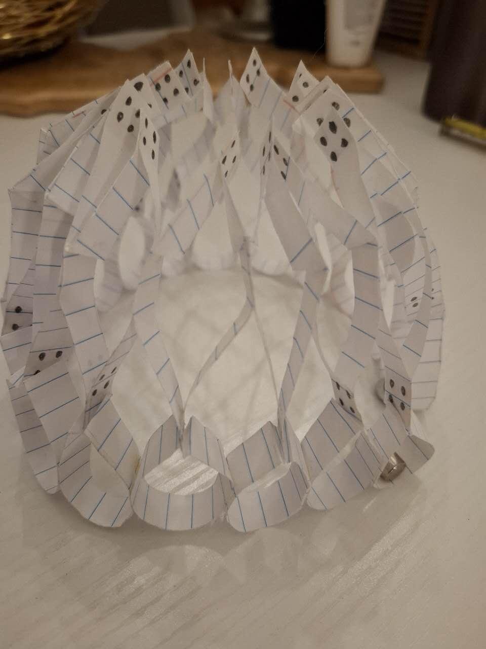

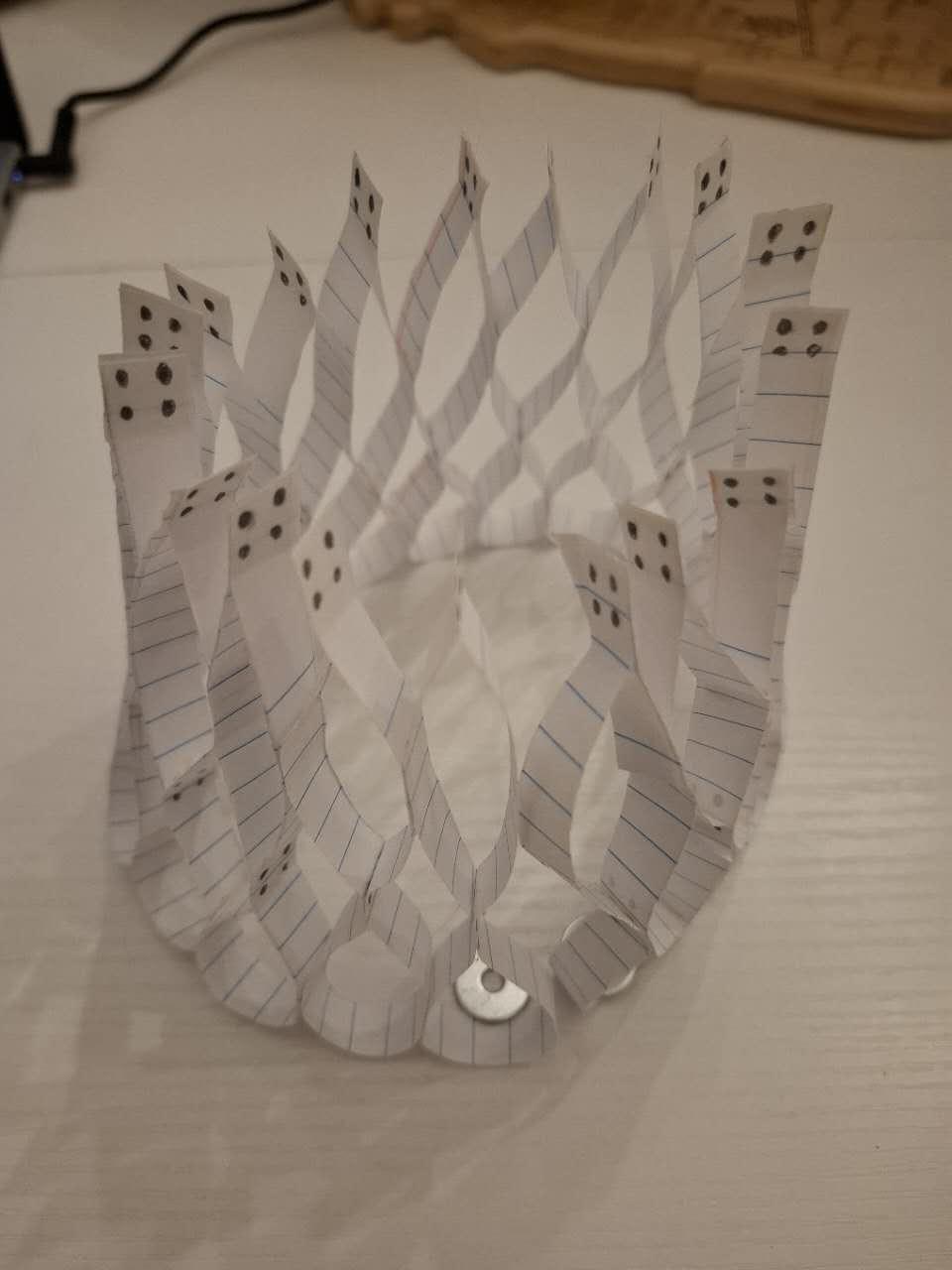

I started with a tiny 1:20 scale model using notebook paper.
At first, I tried straight components, hoping they'd curve naturally into a dome. But not work.
Each piece needed to bend into an arc. Curves are magic when it comes to forming space.

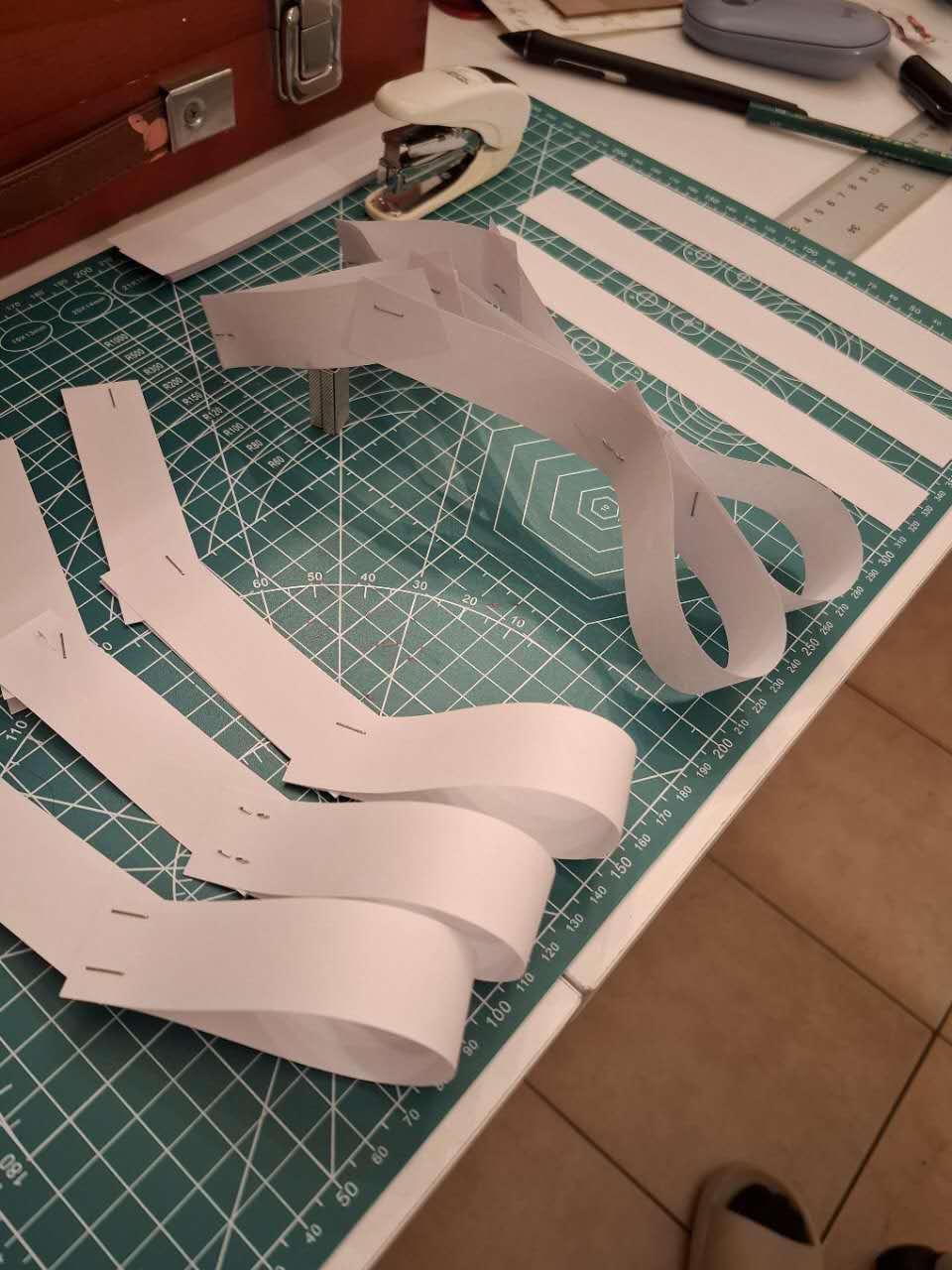

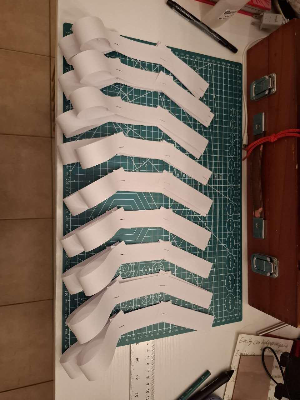

I upgraded to sturdier white cardstock for the 1:10 model. I bought 1 inch x 8 inch paper strips.
To make construction easier and more precise, I decided that each structural unit should consist of three paper strips:
The first strip is folded and gently bent to hold a curved shape;
The other two are folded with defined creases to help maintain angles;
All three are stapled together with slight offsets—each forming around a 5-degree angle with its neighbors.
I made 18–20 identical units. They looked like structural flower petals!

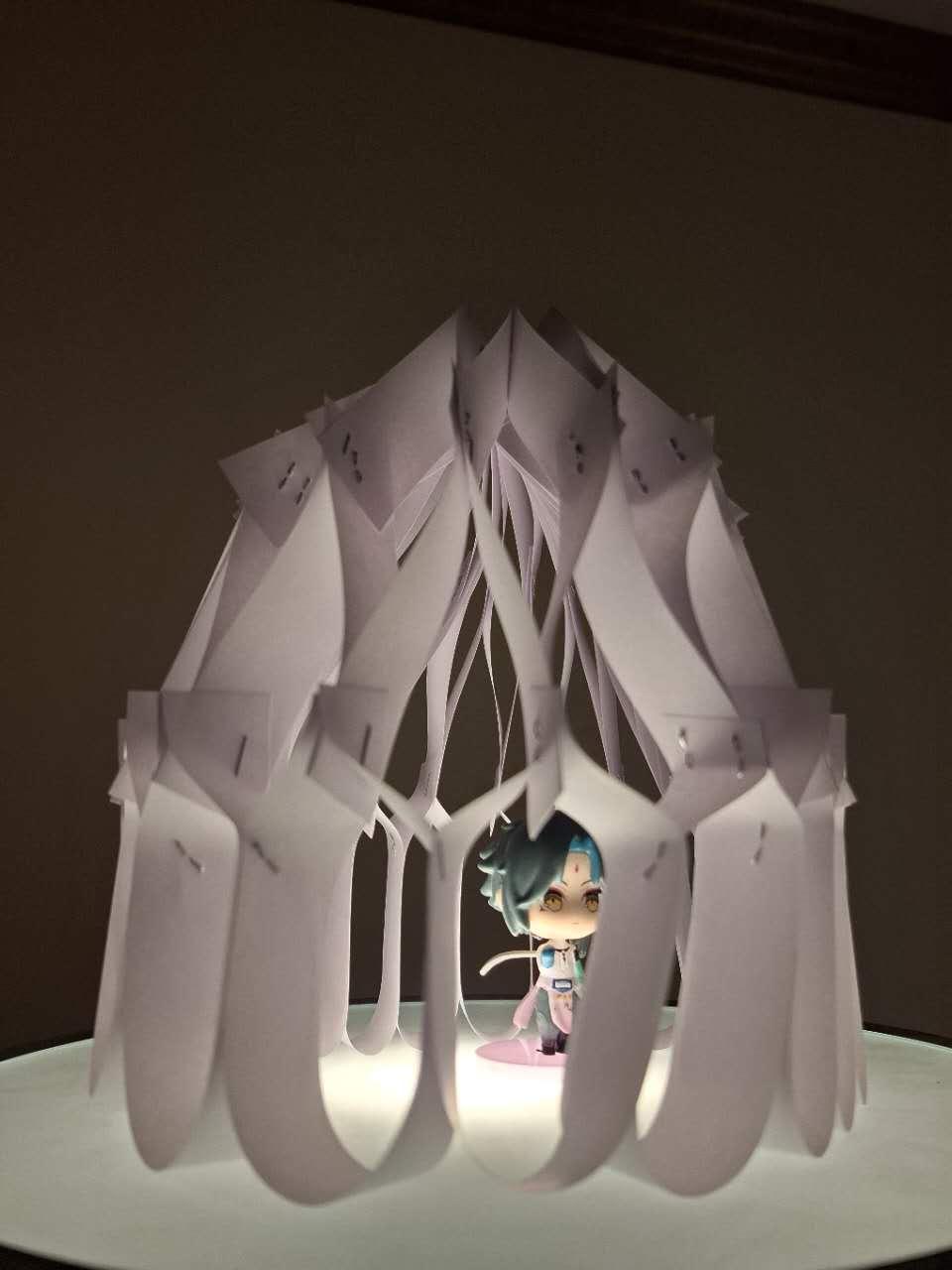

Each unit was stapled at two connection points to form a circular chain. When the ends met—boom!—I had a stable, dome-shaped structure. A tent was born!
Here comes the fun part. I gently pulled the outer edge of the circle outward, then flipped the center upward. Just like that—snap!—my tent turned into a sunshade. The transformation felt like flipping a pancake… but way more architectural.
