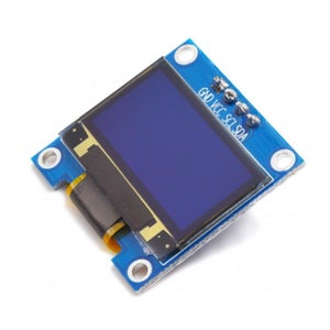

Screen
We’ll be using a 0.96-inch OLED screen. Because when I searched "Attiny85 I2C screens" I found several working examples using this screen. 🙂

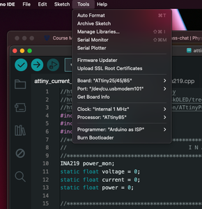

2.5) Install ATtiny board support in Arduino IDE
  1. Add the ATtiny board package by going to Arduino IDE → Preferences → Additional Boards Manager URLs
  2. Paste in: https://raw.githubusercontent.com/damellis/attiny/ide-1.6.x-boards-manager/package_damellis_attiny_index.json
  3. Library found here https://github.com/damellis/attiny.
  4. You can see in my provided picture that I have a few others installed as well.
  5. For more details, check out this instructables

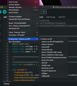

3) Upload your code (provided below) to the ATtiny85
  1. Open your code in the Arduino IDE
  2. Go to Tools → Programmer → Arduino as ISP
  3. Set Processor to ATtiny85
  4. Set Clock to 1MHz
  5. Select Board as ATtiny25/45/85
  6. Upload your code!

OLED Code
The OLED display uses the Tiny4kOLED library, which can be found in the Manage Libraries tab in the Arduino IDE.
